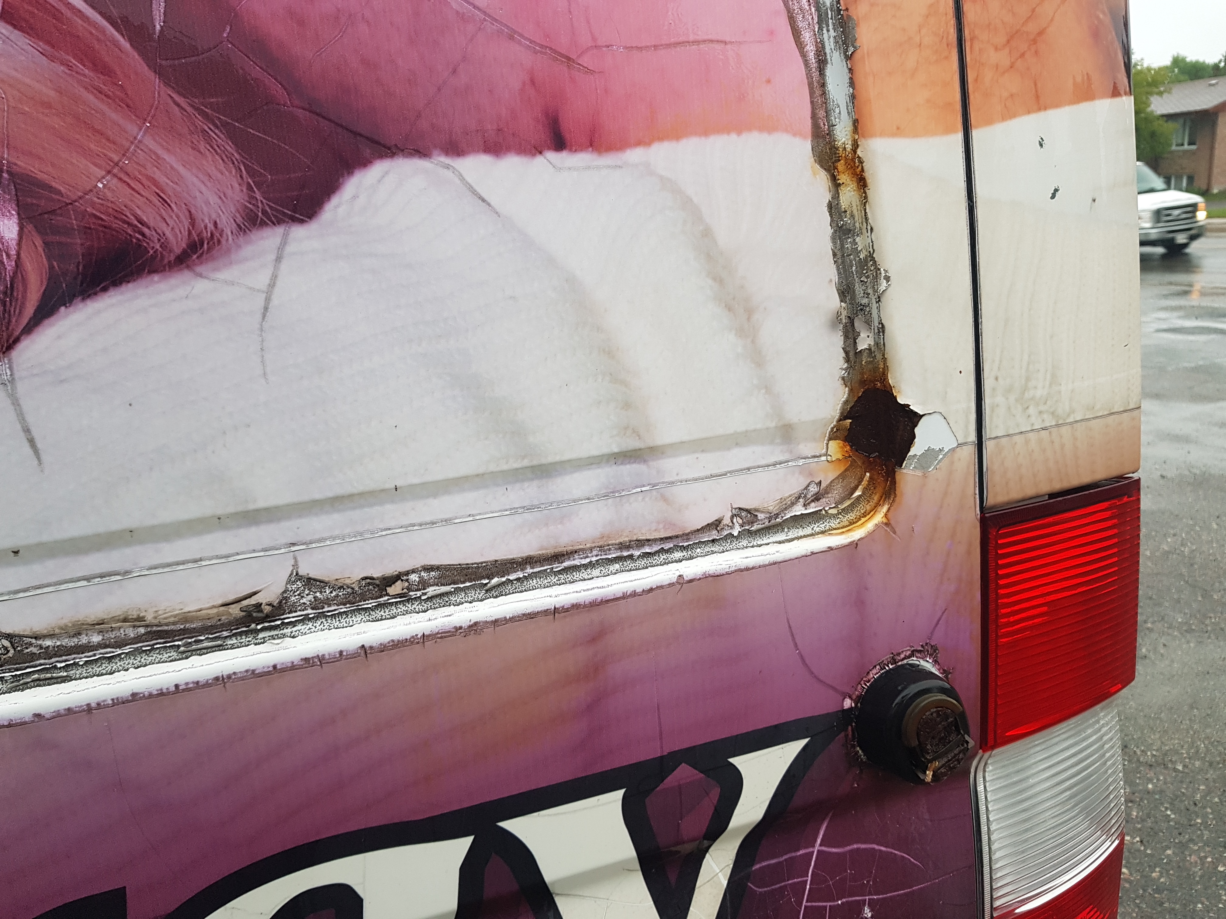

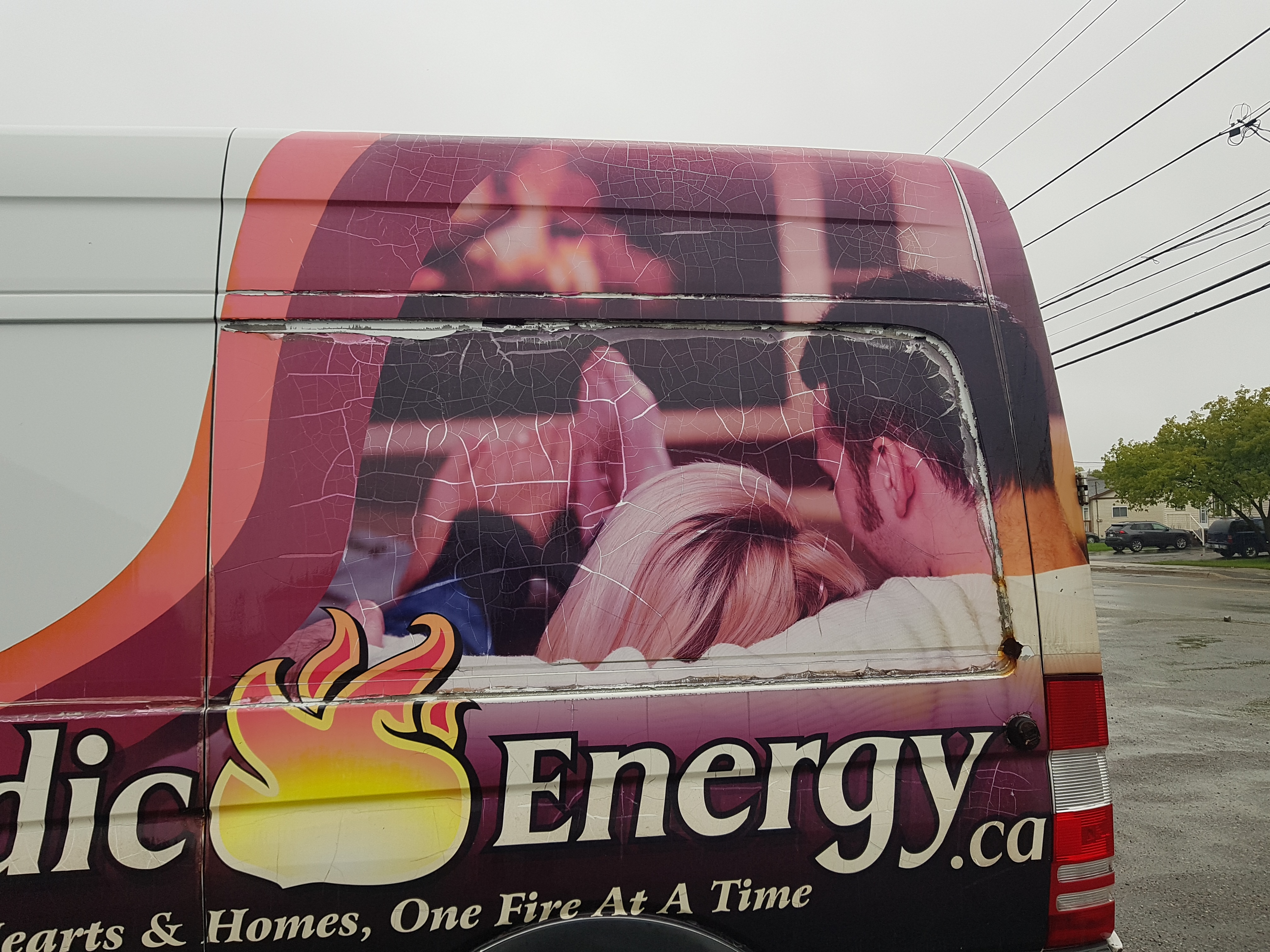

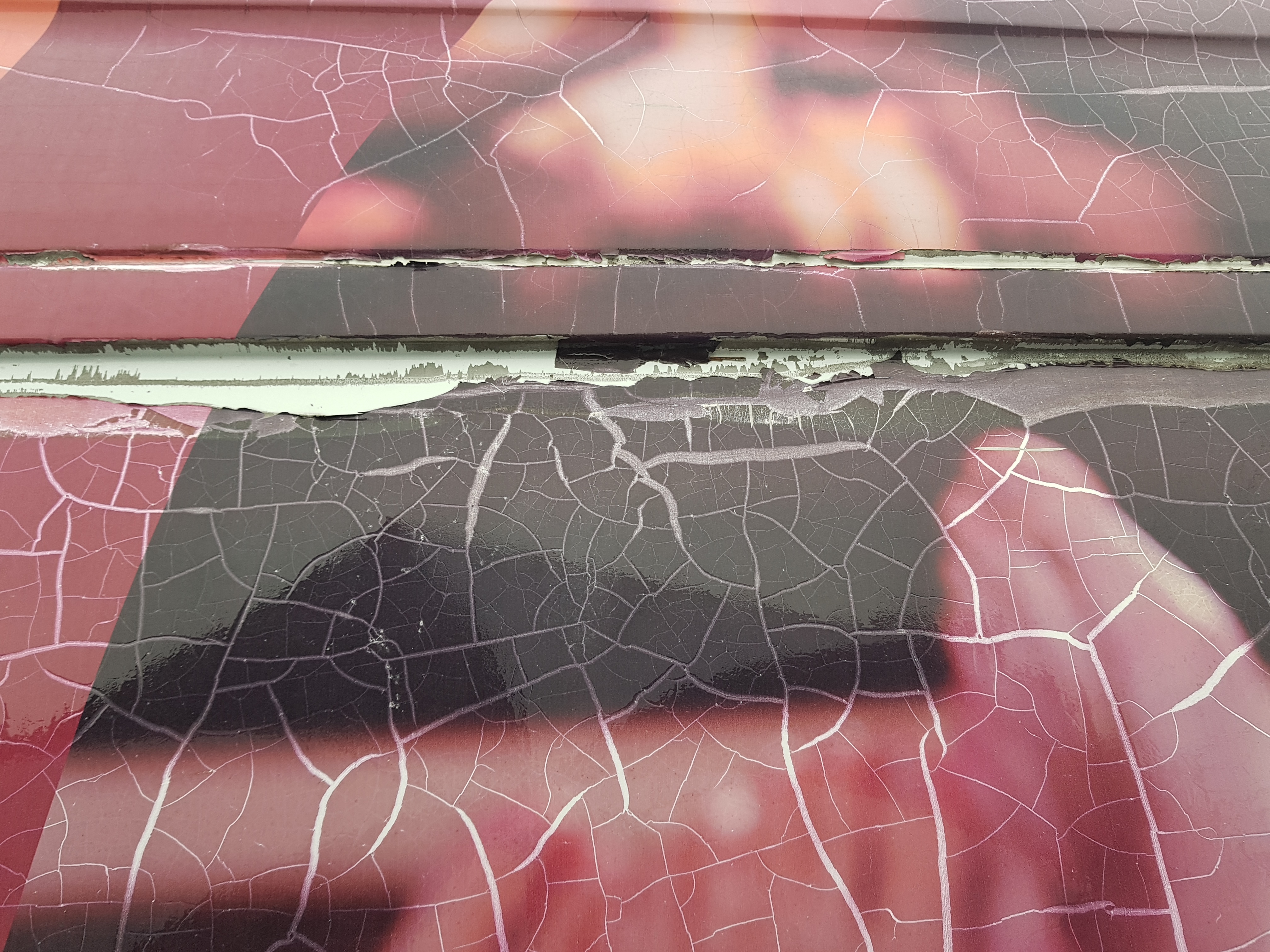

I have been asked to remove this old wrap from a van and it is all cracked and weathered to say the least!
I would like to know if there are any tricks or chemical products that would make this vinyl removal easy?
I do have an MBX tool but am hoping there is an easier way!
And I do not want to start pushing a razor blade scraper down that will most definitely scratch the surface, though I know it will need a new paint job anyway!!
Any help or direction is greatly appreciated!!

You can search on here for this subject and you will see tons of different suggestions. We will only do removal on a time basis and decide the method once we start working on it. The method varies depending on how it comes off. But mostly I tell the client to get it done at a body or detail shop because we hate doing it.

Think you are right about the paint being toast under that.
Vinyl is too far gone to come off with a heat gun or torch.

Might try a steamer if you have one or can get a rental.
Second option would be chemical.
Vinyl off will turn the material and adhesive into snot that can be scraped off with a plastic squeegee.
If you can't get that go to Home Depot and get some citrus based wood stripper.
https://www.homedepot.com/p/Citrist...rnish-Stripping-Gel-Non-NMP-HCSG803/307416113
Trick with the Vinyl off and stripper is to leave it on the surface for just the right amount of time. It needs to stay long enough to soften up the vinyl but not so long that is starts to dry up and do nothing. Once you hit the sweet spot it will work pretty well.

My wrap installers' hands are too precious to have them strip off old wraps. I don't even offer the service, I usually point them in the direction of the local "fleet clean" company who uses a high pressure acid solution wash to remove graphics from vehicles. For lets say, a sprinter van, it's going to cost them $200 bucks as opposed to 30 plus man hours at $70 an hour in shop. No brainer.
This is becoming more common as printers opt for the cheaper liquid laminate solutions on horizontal surfaces. Once the vinyl has become "spider-cracked"(split into less than 1" pieces that do not touch), we no longer consider it to be vinyl and more aggressive methods are tested for best final results. This is the time too confront the client and define their goals. Are they selling and want to just de-identify? Trade in? Re-wrapping? Junk yard? This helps to establish parameters for collateral intent (budget vs appearance).
If cost is the priority, we apply heavy duty paint remover then pressure wash away(*Suitable PPE should be used as well as designating a safe work perimeter). If appearance is the goal, we attempt our blast method first where we utilize a 7000 psi cold water pressure washer with a custom hand piece and harness, experimenting at proximity and angle for the most economical results. Sometimes a combination of less caustics chemical (example:CitriStrip Safer Paint remover) and pressure blasting will yield the best possible result.
