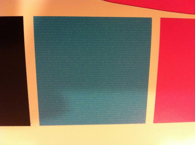

Here is a pic. I'm seeing this affect in mostly magenta and cyan. This isn't the actual print patch that has one fine line going through it (couldn't get good pic).
This a a 2"x 2" swatch filled with 100% cyan - 720x720 unidirectional from Flexi 8.6 on Mac.
I took a skinny pieces of foam (my wife uses to apply makeup) soaked in in solvent cleaner and parked the print head over it for about 15 minutes. When I printed it again it was a little better, put not perfect.
Heres the pic...sorry it didn't attach

Well, if it were me, I would try some more aggressive cleaning then, before I went and swapped out the head. These printers arent exactly known for beautiful printing, but you ought to be able to do a little better. Do a head soak, then pull the dampers and inject some cleaning solution through the head. Use a syringe and a peice of tubing onto the nipple. Be very careful, the nipple is sort of fragile.Use MINIMAL pressure on the syringe. Do this several times, then a cleaning cycle, then a nozzle check.

I too, am pretty much in the same spot you are. My cyan is nearly identical.
I am new to this, and have read about soaking the heads. I don't exactly understand the whole parking the head thing? So you took a piece of makeup foam, saturated it, then stuck it under the heads? Where do you do this at? Middle of the printer?
Also back to the cyan. Is this considered banding? I started playing around with the step adjustment... But need to get my heads soaked I believe

print a pure cyan block with profiles turned off to see what the machine can do when not being interfered with by the profile.
Graphics2u
This is a good point to start at. Then you at least eliminate the profiles in the equation all together.
You also need to do the nozzle test. If it's missing nozzles you never get it better unless you get all of them firing right. Is it just Cyan doing that?

I think I had a combination of problems.
1. The print head needed a good cleaning.
2. My heater was way to low. Set to 36 degrees. I upped it to 48 and the banding is virtually gone. I can only see it cause I know that it was there. May need just a bit more heat. On one print the paper was a little rippled and it rubbed against the bottom of the print head just a bit. Might be able to adjust the icc profile it puts down a little less ink.
I think I'm going to pump some more cleaner through the head like Auto-FX suggested and I'm willing to bet banding goes away completely.
