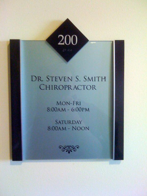

I went to my chiropractor the other day and while I was there he showed me this sign he wants to change the hours on.

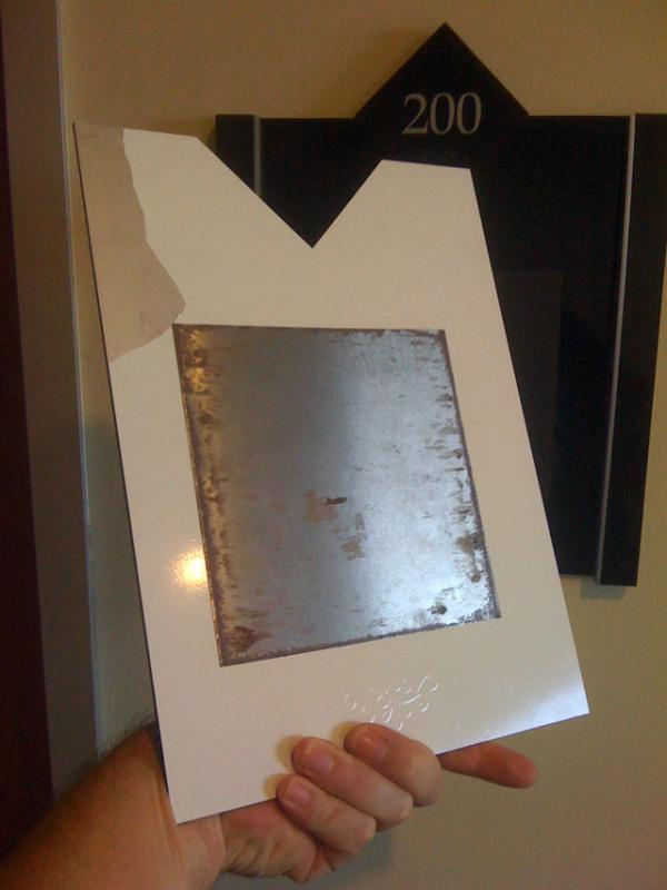

Its 1/8" clear acrylic with lettering applied from behind, with paint or vinyl applied over that (the bluish silver color) and then white vinyl on top of that (Looks like someone tried to peel it off.)
Then there is a piece of furious metal stuck on top of that.
Magnetic material holds the sign in place.
We don't do ADA signs or anything like this so I'm kind of stumped here. I'm thinking this has to be something standard that can be ordered.
Or should I just go ahead and fab this from scratch?

That's an interesting design but you make it yourself of course, just as you described it. That isn't like any mass produced sign system I've ever seen.
garisimo
Reverse cut vinyl letters...
on clear polycarb, then backsprayed with the blue, and then laminated with the white vinyl...
-g-
dman0427
where would I get a super thin piece of metal to stick to the back? Its almost like a sheet of paper in thickness!

Would just standard 024 gauge steel be too thick?
