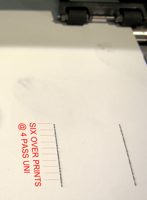

i've got a black head that is going bad and it's getting overspray near the capping station. this has caused the encoder strip to get a mist of black.
today i cleaned it off really well, thinking that was my issue. now it's perfectly clean and the printer is still staggering to the right dramatically.
attached is an encoder test file i use to diagnose encoder issues. (you might want to save it). it's a grayscale 60" x 1" of single pixel vertical lines one inch spacing. in your rip set it to about 720x720 4 pass UNI, overprint six times. this allows the printer to run the same track and you can quickly see the movement sideways without using up media. also you can set the Y/0 further in on your platen and see if you can isolate the area of the encoder strip that is skipping steps.
my question is:
how do you clean the encoder sensor on a jv3? i couldn't get a piece of card stock with iso' or anything in there. do you have to take it off? the compressed air can did nothing.
i am in dire straits with a sunday deadline. i really really must be printing right now. not doing repairs. so any ideas no matter how odd will be much appreciated.

i looked at the service manual and there are two pages of badly translated tests. they compare all kinds of y motor distance vs. encoder distances to diagnose if the y motor or the encoder is the one losing steps. i find the whole two pages of describing the test unintelligible.
considering this is a low mileage printer and i've got the overspray already found on the encoder strip, i'm going to bet it's the encoder sensor. i just can't see how it can be cleaned thoroughly without removing it. the access is just to tight.
i think if there's not some "tape" this to that then run that passed this type of a cleaning option, i'll just take it off and get it under some good light.
i am down to counting wasted minutes. this truck is leaving at 10am sunday. and i don't see it all coming together.

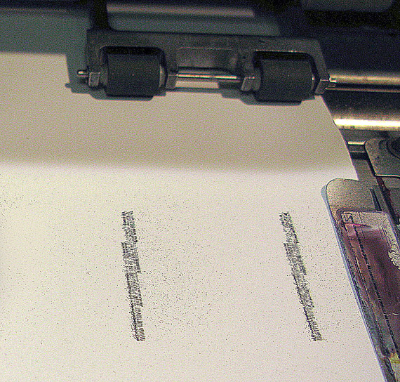

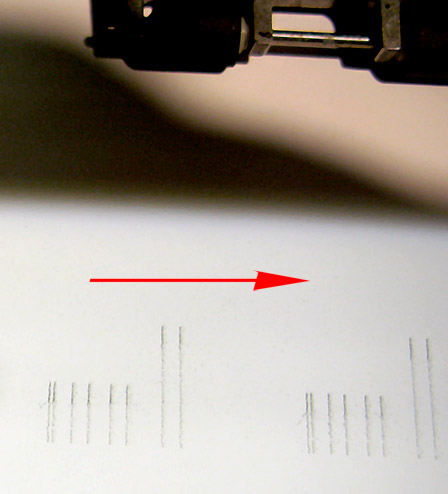

well, took the encoder off. looked extremely clean under magnification. all i found was one single cat hair. ...which i think was about 99% the cause of it the drift. over about 30 passes, i'm off about 2mm. that would account for a single speck somewhere on the encoder. i'm going to go down the encoder strip with a flashlight, piece of white paper, and magnifying glass and i bet i find this missing speck.
update on this boring encoder thread. maybe it will help someone in a pinch someday..?
i found only one tiny speck of magenta ink. but that was the final fix. i've attached a pic of it dirty vs. clean. note that there is overspray on the "still dirty" photo. the head isn't perfect but it is printing much better now that the encoder is spotless.
shown in the final pic is a 1" x 1pixel line overprinted six times. the x advanced about 10 times to cover the inch.
