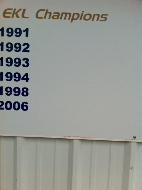

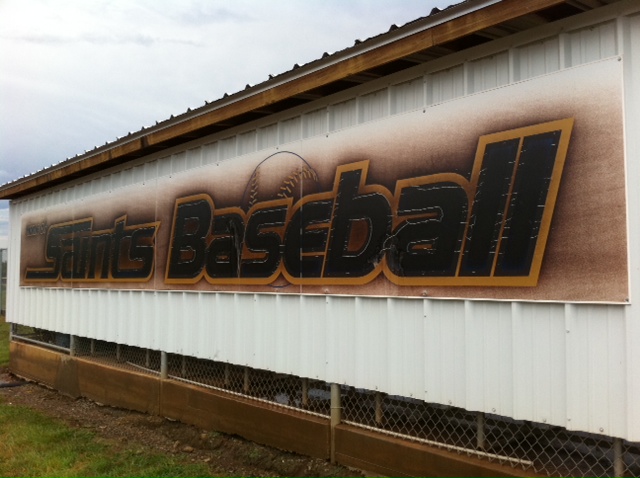

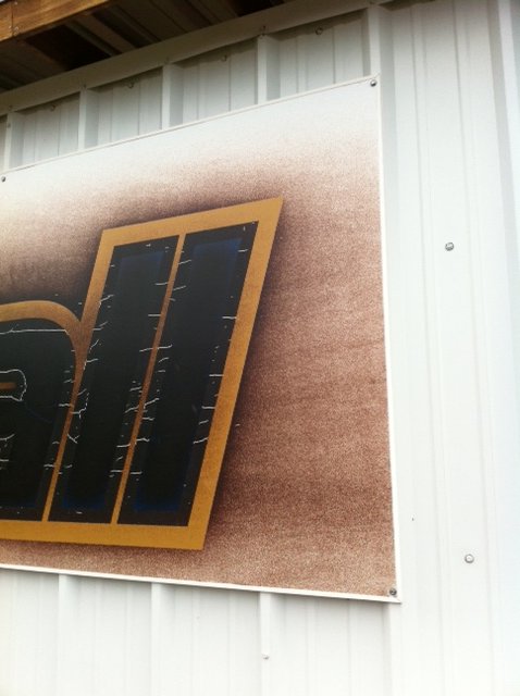

We are doing a sign to replace this one for a client. He says it has been up for 3 or 4 years. It is determinately printed on adhesive backed vinyl and laminated with a matte lamination. I don't know specs, but I do know it gets a lot of sun exposure.
They want us to see if we can redo this and print on something that wouldn't do this (the client thought it was rust. It took some convincing to tell him vinyl doesn't rust...:banghead:). It is applied to alumacor panels. I've attached a picture of a similar sign printed but that has some protection from the sun for a good portion of the day, but if you look close at the bottom edge, you can see this phenomenon creeping up on that sign as well.
Thanks for the input.

Probably just the sun baking the overlam turning it brown. PLastic type products tend to do that when left in the sun for too long.

My guess is that because the letters are black, the area over them is retaining heat more than the white surrounding. If it's on Alumicore, the metal may be heating up as well under the black. I'd guess it's the adhesive baking off under extreme heat. Try holding a thermometer to it and seeing just how hot it gets, and comparing that to the specs of what the laminate is usable for. Just a guess - I'm a sales guy, not a production guy ;)

It's the lmainate, I have seen the same thing is the pass where cheaper laminate is used and it turns brownish and or yellowish.

Cheap laminate without UV inhibitors!
Vinyl will turn brown form the UV rays ... that is why they put in inhibitors when formulating it.

I've seen that happen with cheap calendered laminate used on vehicle graphics. It does look just like rust, one time I peeled part of the laminate off and print underneath looked perfect.

Thanks for the feedback guys. I assumed it was a cheap lamination. I also assume if I use a good UV lamination that it will hold up to its advertised rating.

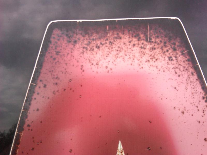

I have seen this before as well and was not quite sure why. After examining pictures, one might conclude that the top of the print is still white because
it has still a bit more shelter from the roof and does not get as much sun exposure as the rest of the print.

I've only had a similar problem once. It was avery A6 silver vinyl printed with eco-sol max ink, unlaminated. Only the graphics on the hood and roof where affected by a brown "stain". The graphics on the side of the car where fine. I tried variouse products hoping the clean the brown but nothing worked. I was told that the car had been parked under a big tree for some time so I naturally came to the conclusion that the sap from the tree and sun had caused the browning. It doesn't look like you have any trees in the photo so now I'm rethinking my original conclusion. Seeing what other have written, it seems like the sun alone can do this. The weird thing is that I did several cars with the same graphics package and it was only the one that was parked under the tree that had the problem.

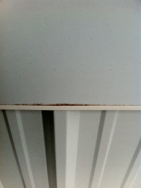

After reading what I wrote, I thought I would go to my back door to inspect 2 decals I put on it back in oct 2006 as a test to see how well the inks would hold to southern sunshine on a door that gets awfully hot in the summer.
One was laminated with 3ml laminate and the other had none.
Up until this spring...5 years after they were put on the only difference was that the unlaminated version had some noticeable fade but not to bad.
10 minutes ago I looked and in those 2 months since I looked at them the change is incredible.
The unlaminated one is almost devoid of any ink and the laminated version has the same rust look running along one side.
The laminated version has that rust look running along the right side...so it is defiantely a laminate issue although I would choose that over having almost pure white graphics lol
