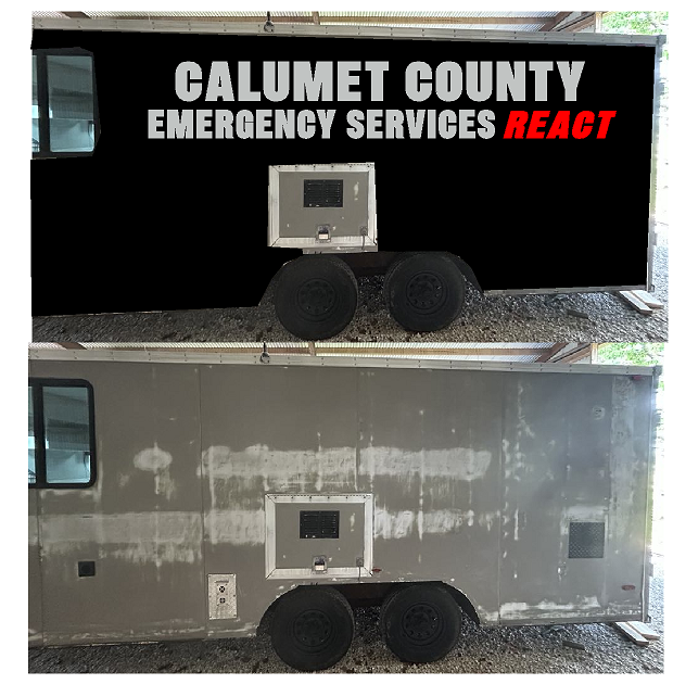

24' Trailer was painted black over the weekend...Oracal 751 Silver Gray Metallic and Red Reflective
He told me 48 hours...I said longer than that. No idea what kind of paint they used, should I ask?

I'm going to go look at it again they said it turned out "bumpy"...good Lord...I'll report back with some photos and more details.

Update! Well folks...I won't be lettering this trailer LOL You know that spray they put on truck bottoms so they don't rust out? It's black matte and sandy? - Well...that's what they used LOL
Anyway, I'm going to put the lettering on aluminum instead and they will attach the panels. Good thing I went out there!
