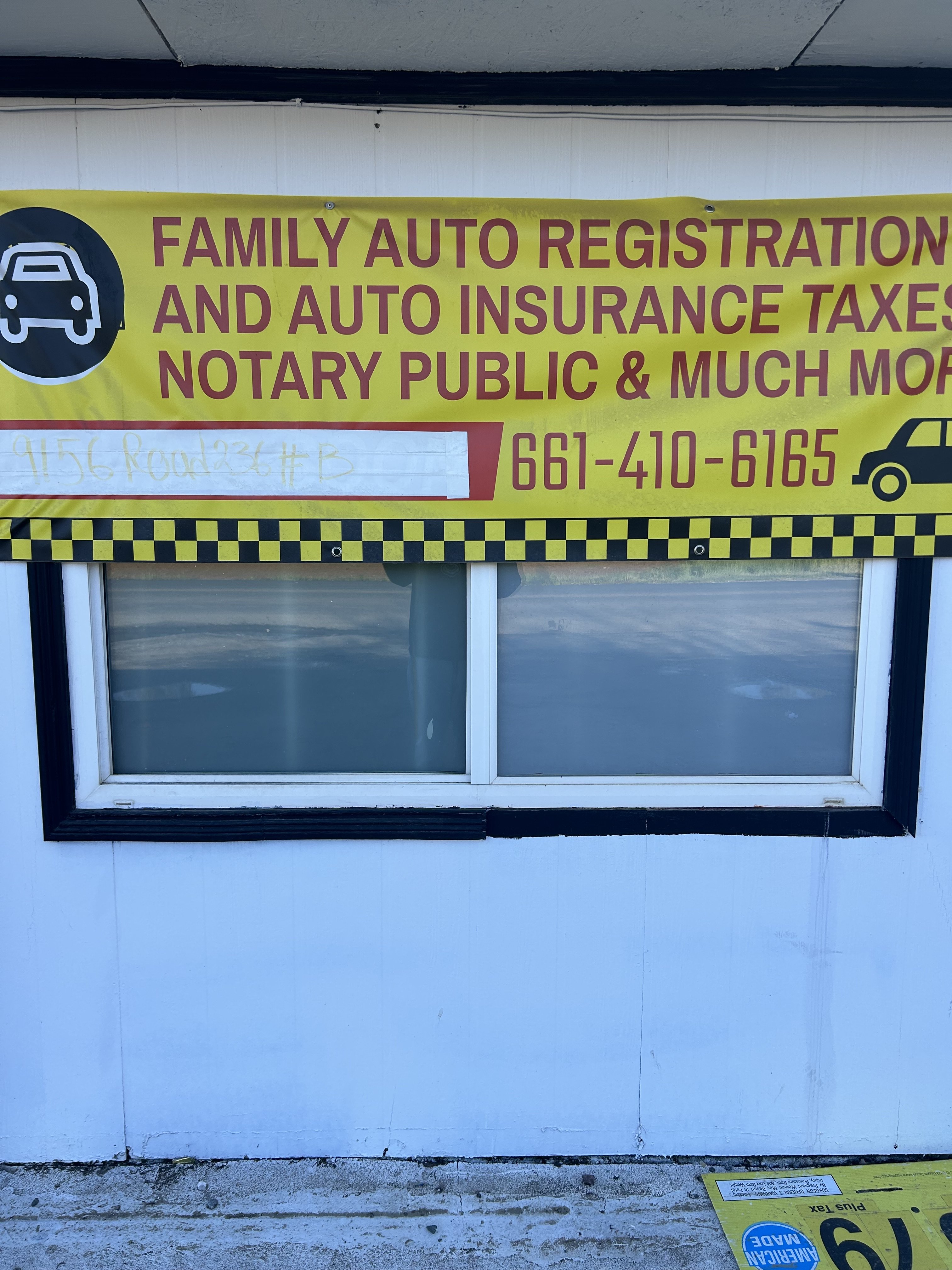

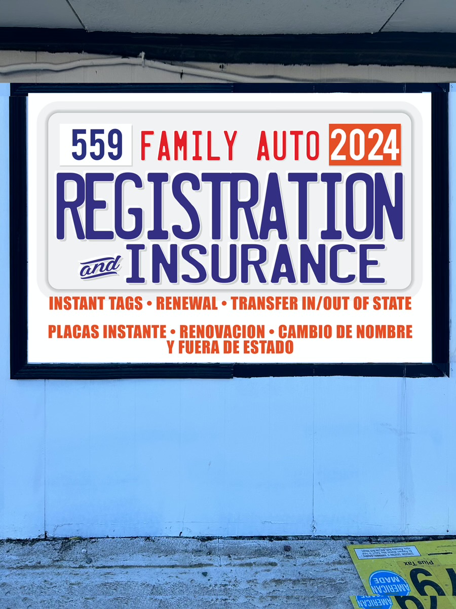

I just got a job to apply graphics to store front windows, but instead of perforated vinyl they want to go with .020" styrene.
I've applied tons of perf vinyl, but never had to apply plastic directly to a window frame, so need y'all's expertise.
I can add grommets to each corner.
Pics for reference
Thank you in advance!

Thanks! They are 6x4 feet, placed on the exterior, and he's wanting them long term.
The building is off the side of a small highway with moderate wind at times.
