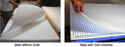

Material that will STAY FLAT is very important, especially when used for years. But the best investment for that flat table is a self-healing mat. It protects the table surface and allows you to trim your prints in the same workspace. Speedpress makes a good one and there’s an optional grid available.
