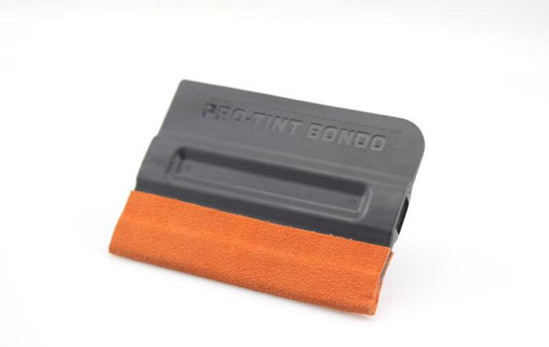

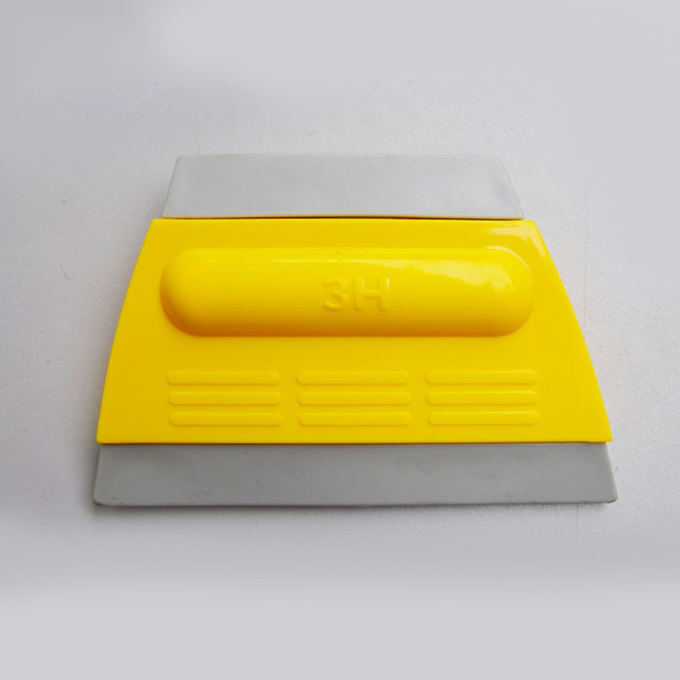

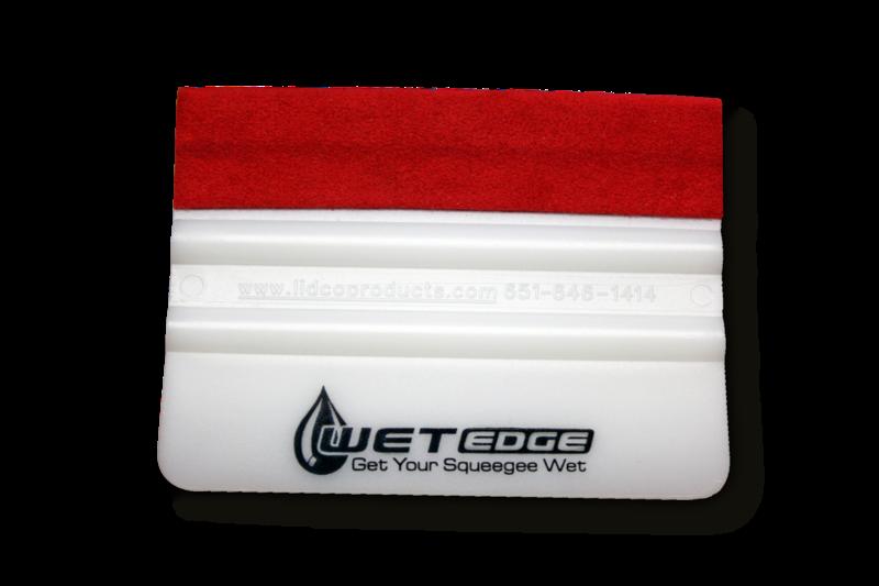

phototec
I use what they call the wet edge squeegees, covered with two layers of Ultra Suede, however I make my own.
Just go to the local fabric store and purchase some Ultra Suede, then I apply the first piece (4"x1") along one edge using double sided banner tape, and then apply the second layer (4"x2") over the fist piece.
I use RapidTac application fluid, (however you can use water wit a few drops of dish washing liquid), in a spray bottle and keep the area wet when squeegeeing, no scratches..
