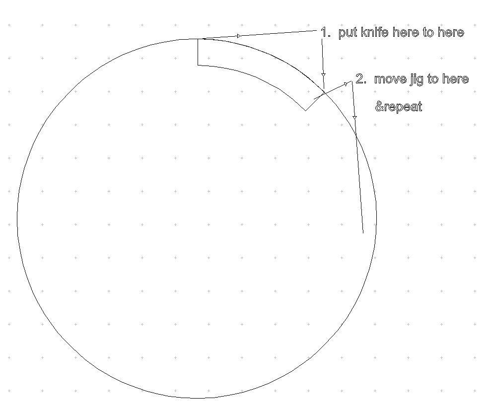

MikePro
overthinking this. print it in one-piece with a black outline. ....and then use a scissors or steady-handed xacto to cut it.
sign guys used to freehand everything, but you have the benefit of printing your target cutline so use it.
if you NEED a jig, cause you simply cannot do it by-hand, then just make a dibond template for a ~24" section of the perimeter and use it as your guide around the circle as you go.
