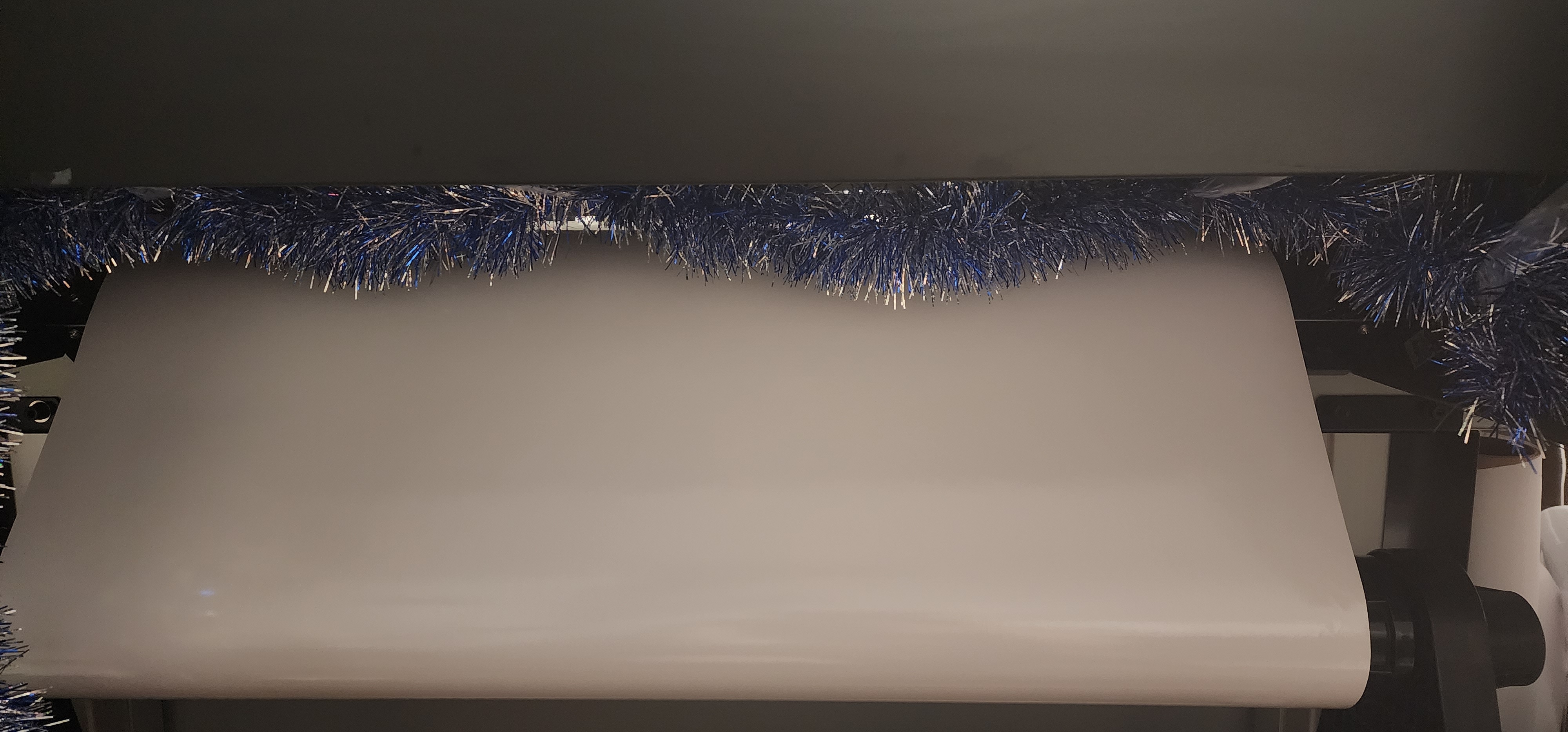

I have tinsel at the back of my printer. ( did I do it right ?) I have air purifier. I mop the floor before printing. I wipe the vinyl clean before printing
And there is still this freaking dust . What to do ?

There is always dust on the print. Some pieces are pretty big. I don't know where is it coming from .
I have tinsel at the back of my printer. ( did I do it right ?) I have air purifier. I mop the floor before printing. I wipe the vinyl clean before printing View attachment 165424

I've never heard anybody put tinsel up?? I thought it was a joke initially. I could only see tinsel causing issues as it grabs and lets go of dust. Or did I just miss the next big innovation out of the dollar store?

could it be that the tinsel is attracting dust due to static (as intended, I think? never heard of using tinsel) but since you wipe down your prints, the media could be damp and the dust is setting on it instead of the tinsel?

That's not the proper tinsel, you can also get anti static string, instead of tinsel.
