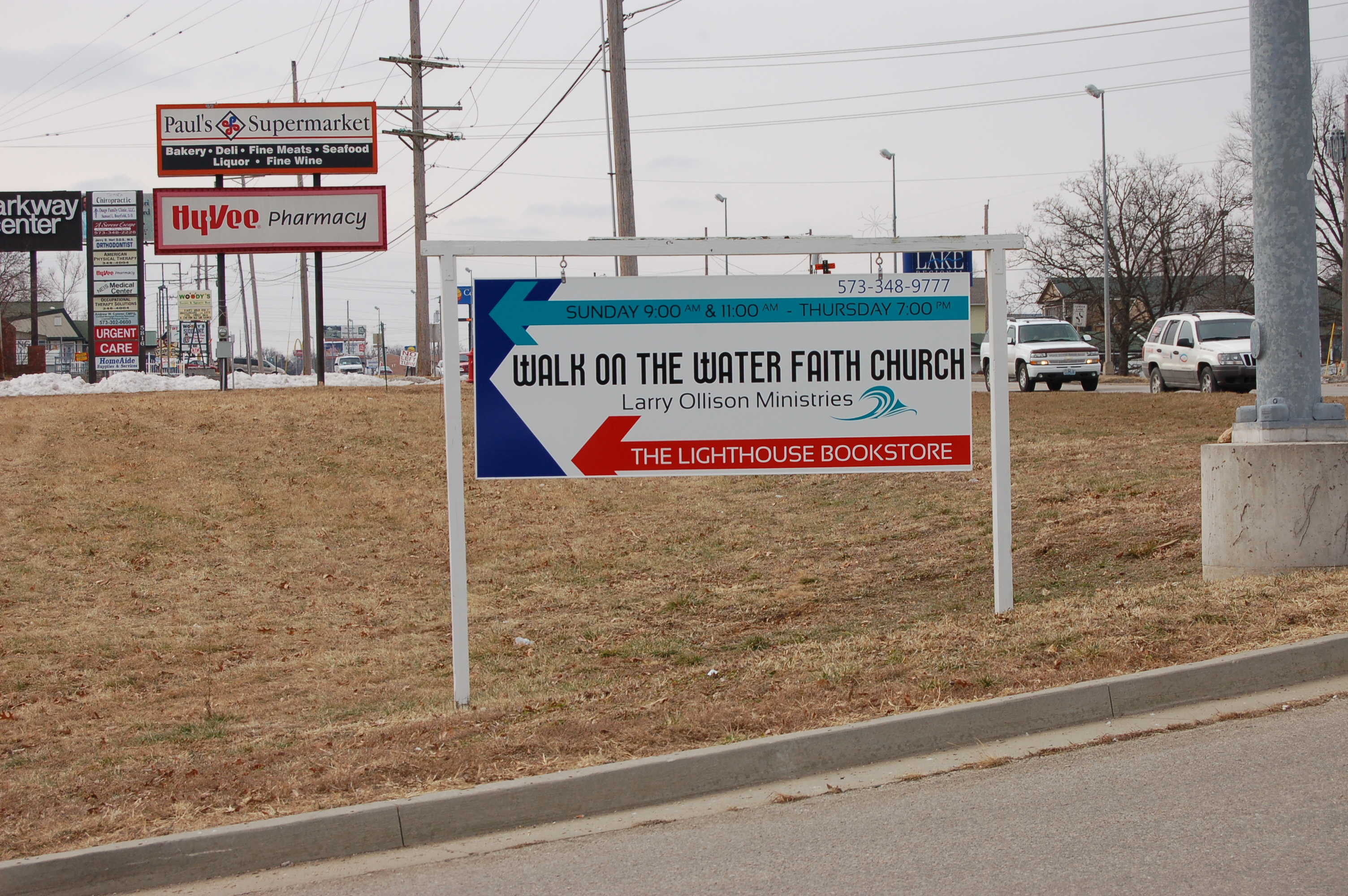

We have a 4x8 we made about 7-8 years ago from two-sided Lusterboard that hangs from two eyebolts on a wood frame. Lusterboard was 1/2" plywood with aluminum laminated to both sides. It has plastic edging caulked onto it. We used metal brackets that bolt to the sign and a screw carabiner to attach it to the already existing frame. Last week we had two days of 40mph plus winds and it's still there, not to mention typical summer storms.
N. Glantz still lists Lusterboard in their catalog, so that would be an option for you if you want to make a single two-sided panel. Note: the church gave us the design and would not allow us to edit it.
One very important factor...... yours has two posts while the OP only has one. On the books, it will never fly, but in real life it will fly like crazy...............

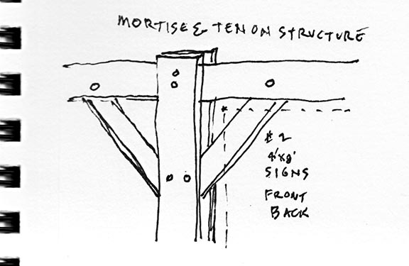

Build two of those, or something similar, out of steel or aluminum It will look good and function well. This will bolt into the post structure and then bolt/screw into the sign. Should be more than strong enough to handle the sign.
As for the sign, build a frame out of whatever you're comfortable with. The mounting will secure to the frame. Then mount the printed signs on to the frame.
EDIT: In case it wasn't clear. One would be mounted at the top of the sign on to the horizontal structure. The other would be mounted to the vertical post. Should have absolutely no problem carrying the weight of the sign.
