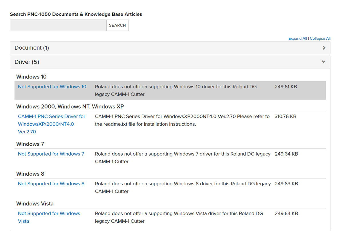

I tried to contact them for help but it was hopeless. I also found this on their site regarding the ol' PNC-1050:

Roland no longer supports downloads of drivers to older model cutters
its to run on corel draw you have to have a plug in which you get from roland cut studio
. i believe that roland cut studio only runs on older windows OS so if you have windows 10 that wouldn't work.
try and reach out to corel draw as well maybe they can assist.

I use our PNC1410 directly from Corel X3, and the instructions I'm sure I've typed if you search PNC1000
But everything must be a hairline outline, get the drivers from Roland Dg website, Legacy systems, and I could not make it work on a 64 bit PC - only a 32 bit PC. I use Win 7 also.
