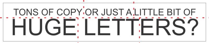

We would break up the artwork into manageable pieces and include registration marks to align the pieces with minimal need for measuring.
If you have a really hard time putting down big pieces of vinyl, you can always do it wet.... But we would have no problem installing this dry, it might be easier if you had two people, one to squeegee, one to hold the loose end of the app tape.

We probably would be weary about plotting something that big in one run (not to mention the width may not all fit on one run of vinyl). We also tape by hand, and anything over 10 or 12 feet is pretty risky. So if we are going to break it up in sections anyway, why not just make the sections small enough install in one piece. (6-8 feet wide)
I do agree about the taping it all down and then cutting it up to install with ease. But once you start plotting everything with registration marks, if your pieces are manageable enough not to need the "hinge technique", two people can slap on that lettering pretty quickly. However, I guess I would consider my way an advanced technique. We wouldn't attempt it if one partner wasn't an experienced and proficient installer.
