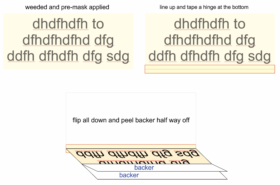

Are you able to keep it as one piece i.e. masked in layout? Line it up, center it etc. once you got it, tape a "hinge" at the bottom edge. Pull the backer off and fold it back using it to hold the vinyl straight. It can be done dry but you could also use a soapy alcohol solution. You can split with scissors and do half at a time if not comfortable doing it all at once.

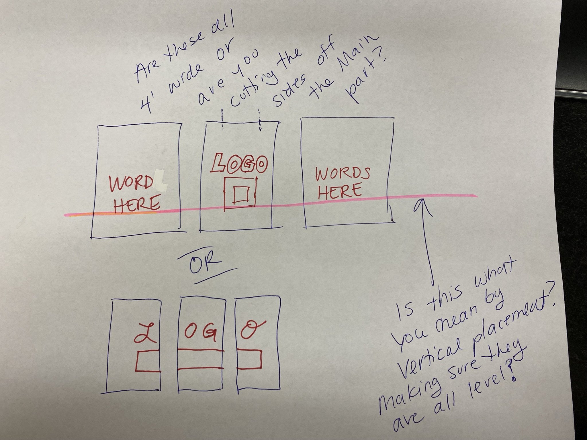

I'm a confused buy your last question, please clarify.

Yes! The top one. But the pieces are pretty far apart. If I mask it all together it will be 12' wide and I know for a fact that I would get it all stuck together and make a huge mess. I guess I was just hoping it was acceptable to use some kind of liquid so I had the option of sliding it up or down a quarter inch if the initial placement is off. Thanks so much for your help on this!

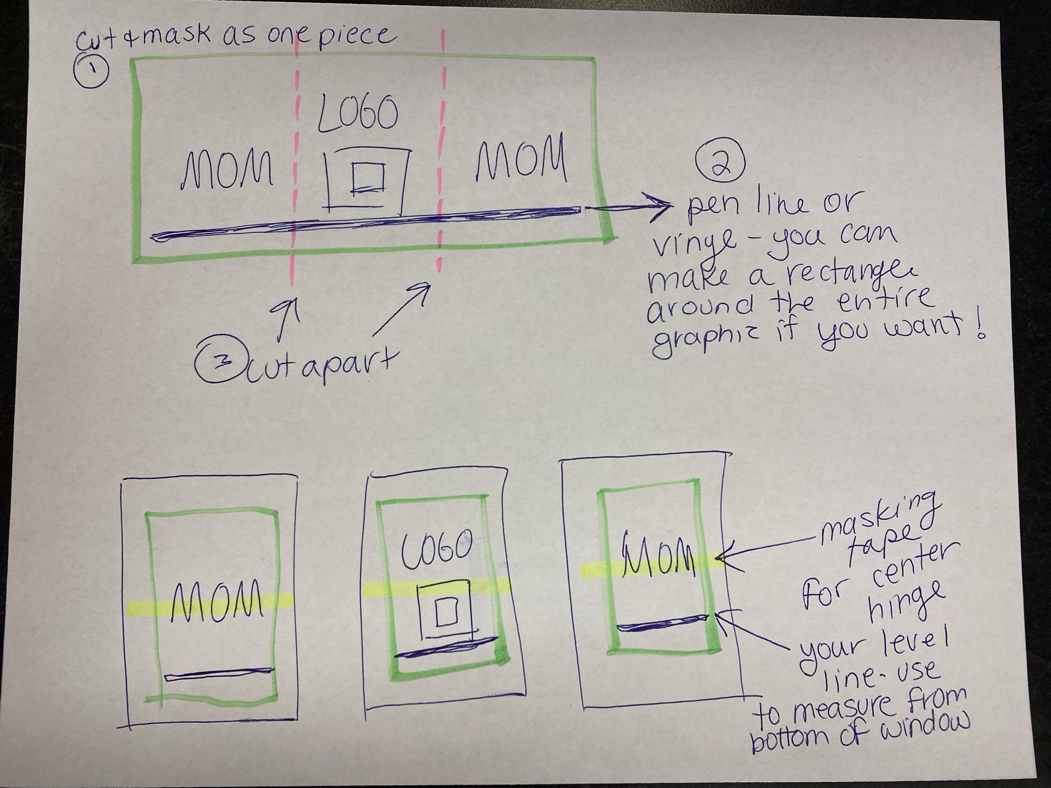

OK, makes sense! I would cut and mask as one piece. Either add a vinyl line under the entire graphic or make a line with a pen. Then cut it apart into your 3 sections. I would tape all sections on using a center hinge. Stand back, make sure it looks good, measure again. I would start with the center section then move on. You can add a vinyl rectangle around the entire thing like Bob said too. Here's my bad drawing LOL
