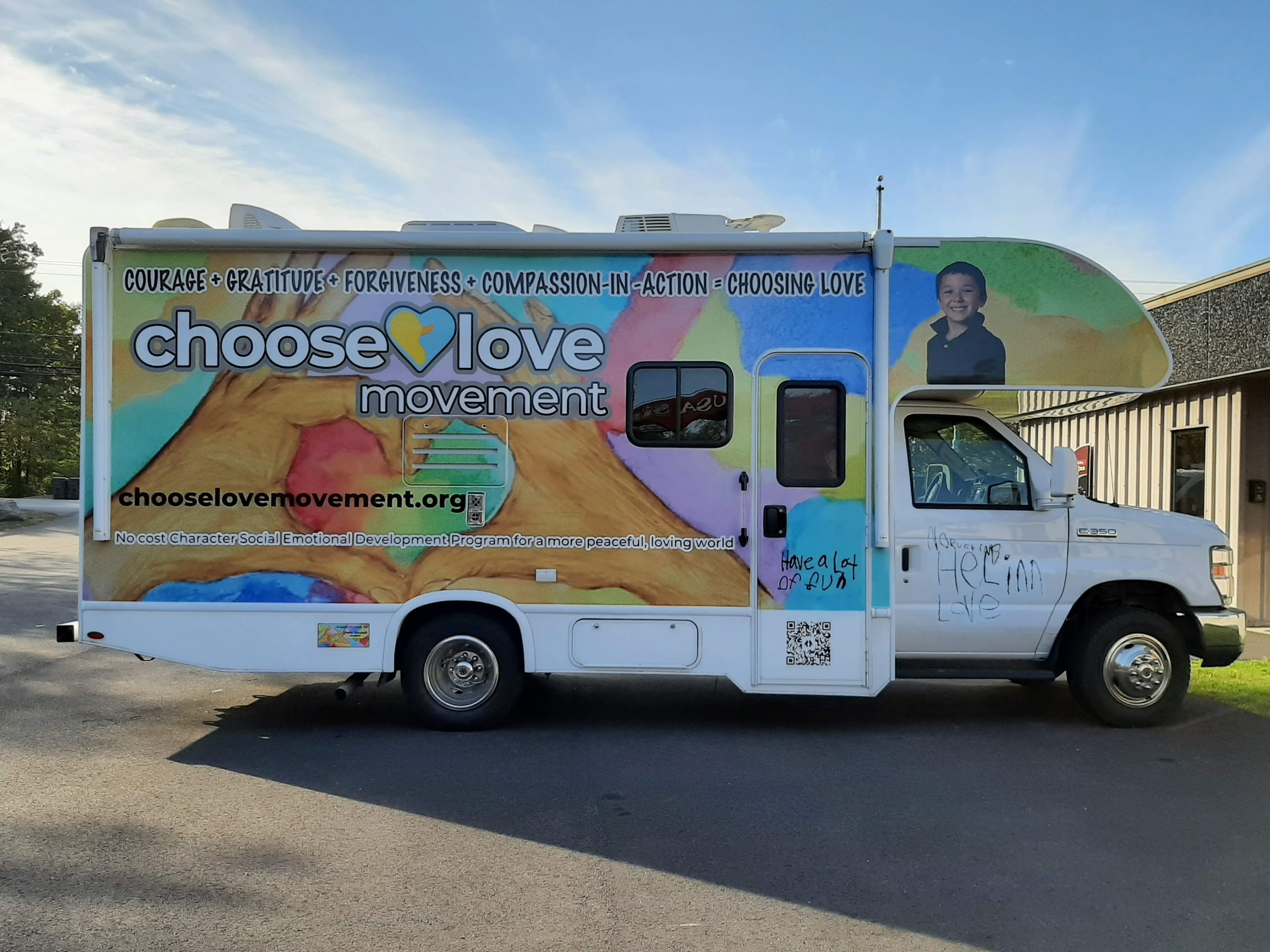

I did a big wrap in Photoshop at 1/4 scale 300dpi, saved each panel separately and blew it up to full scale in Onyx. I can't remember if I saved it as a TIFF or a PDF, but it would have been one or the other. The resolution wasn't perfect on the print but it worked and looked nice.
*I did not do the wrapping, just the file prep, for the record
Looks like Texassignmaker lettered the doors
  • Hilarious!
