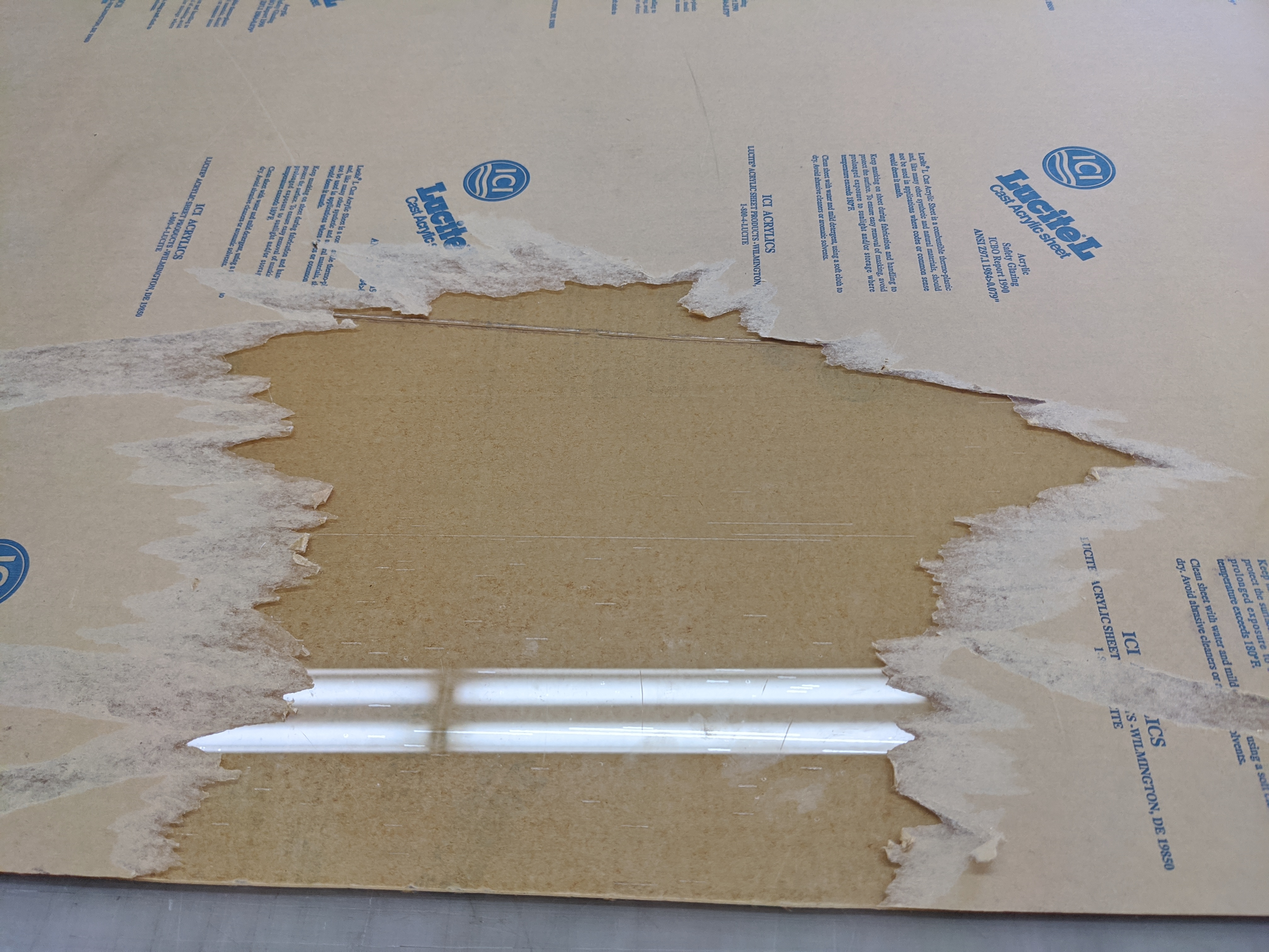

I've got this piece of clear acrylic we're planning to turn into a shield for our counter. The liner is being a PIA to remove. I've tried soaking another piece with Rapid Remover and it didn't help much. These are old, could be 10-15 plus years old. We don't do a lot with clear acrylic. Most my suppliers are backed up on clear. So I'd like to use these since I'll never use them for anything else.
Any help would be appreciated it.

I know you said you tried it, buuuuuuut RapidRemover.
spray & wipe to "wet" the face, let it sit a couple of minutes. then when you start peeling you'll LOVE how the paper&adhesive comes off the panel like the plastic wrapper on a slice of Kraft cheese.
I've salvaged sheets of acrylic that were in the scrap pile for over a decade.

I'll try it again!
bannertime
Well I put some idle hands on it with Rapid Remover. It did take about an hour, but it's done. Don't plan on doing that again.

Lol, I donated some new signs to my church a few years ago and thought to myself "Hey, it won't cost me because I have some old panels that will fit this thing" Well, I spent over an hour... the liner cracked in little tiny pieces and took forever to remove. I don't remember how I actually got it all off, but I do remember thinking I should of just bought new sheets.

If you have some cheap vinyl or laminate laying around maybe try laminating it to the liner and see if it comes off any easier. Just a thought...

Take some newsprint or newspaper and put it on level face and soak with mineral spirts, let soak for awhile and then try to peel off liner, the longer the paper liner has been on the longer the soak.
Stay away from stronger solvents so it does not craze the acrylic.

We had decent luck with soaking the liner in methyl hydrate for a few minutes (4-5) and then rolling it off with an old vinyl core. Wasn't perfect, but we had 75 pieces that needed peeling and no time to return them (I'm assuming our supplier sent us some older sheets, but clear acrylic had been a bugger to find, so we were buying anything and everyhting). So many freaking sneeze guards, I get a stress response grocery shopping now, for other reasons than COVID.

Just let that paper backer soak in plain water for a few hours then rub-n-peel !!!
Any glue residue remaining can be removed with a soft glue remover. A 10:1 water and white vinegar solution with a small drop of dishwasher soap applied with a soft cloth then wipe with a dry soft cloth will act as a perfect and eco-friendly glass cleaner.
Voila !!!

Agree with MikePro. I did it with Rapid Remove but in the spirit of full disclosure there is a chance the Rapid Remove can damage the acrylic. I have no idea how/why but I heard it is so. Mine worked out fine but it was pretty sloppy slathering the thing in Rapid Remove. I kept the doors/windows open because I have a rule: if I can smell it then it's probably not good for me. Being a cancer survivor I watch out for these things.
