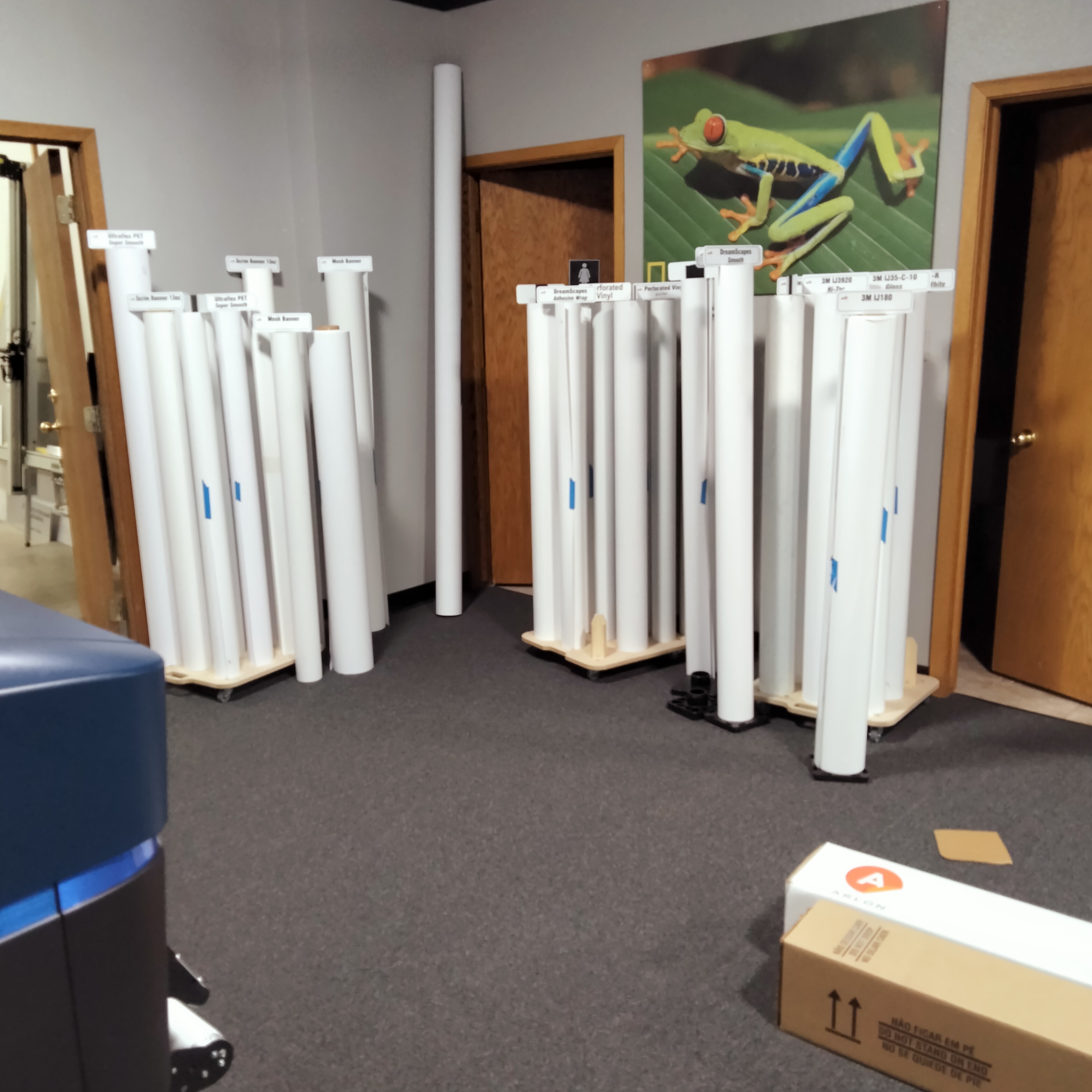

Do you really have to negotiate those dominoes just to go to the ladies room?
Yes, I do. Here's what it looks like today...

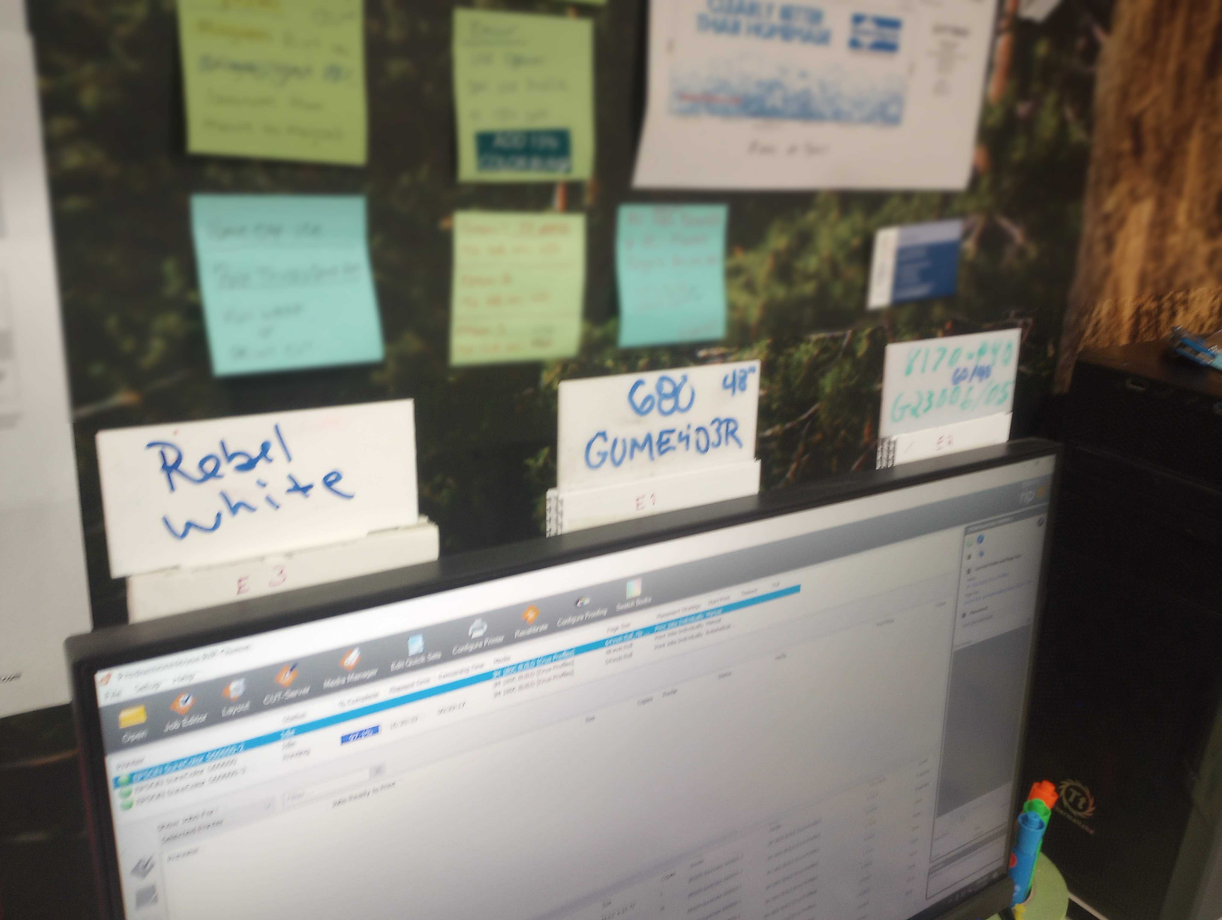

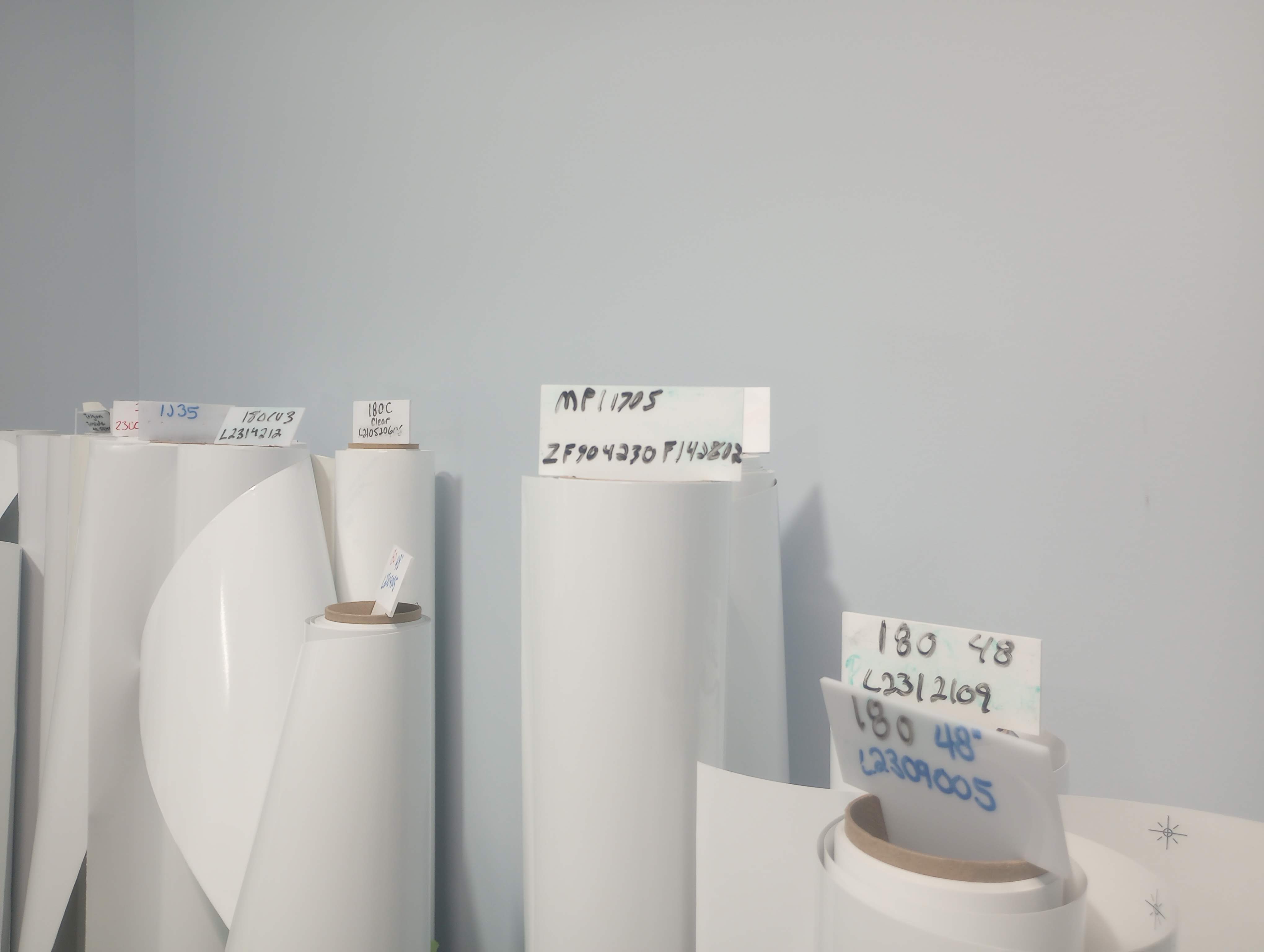

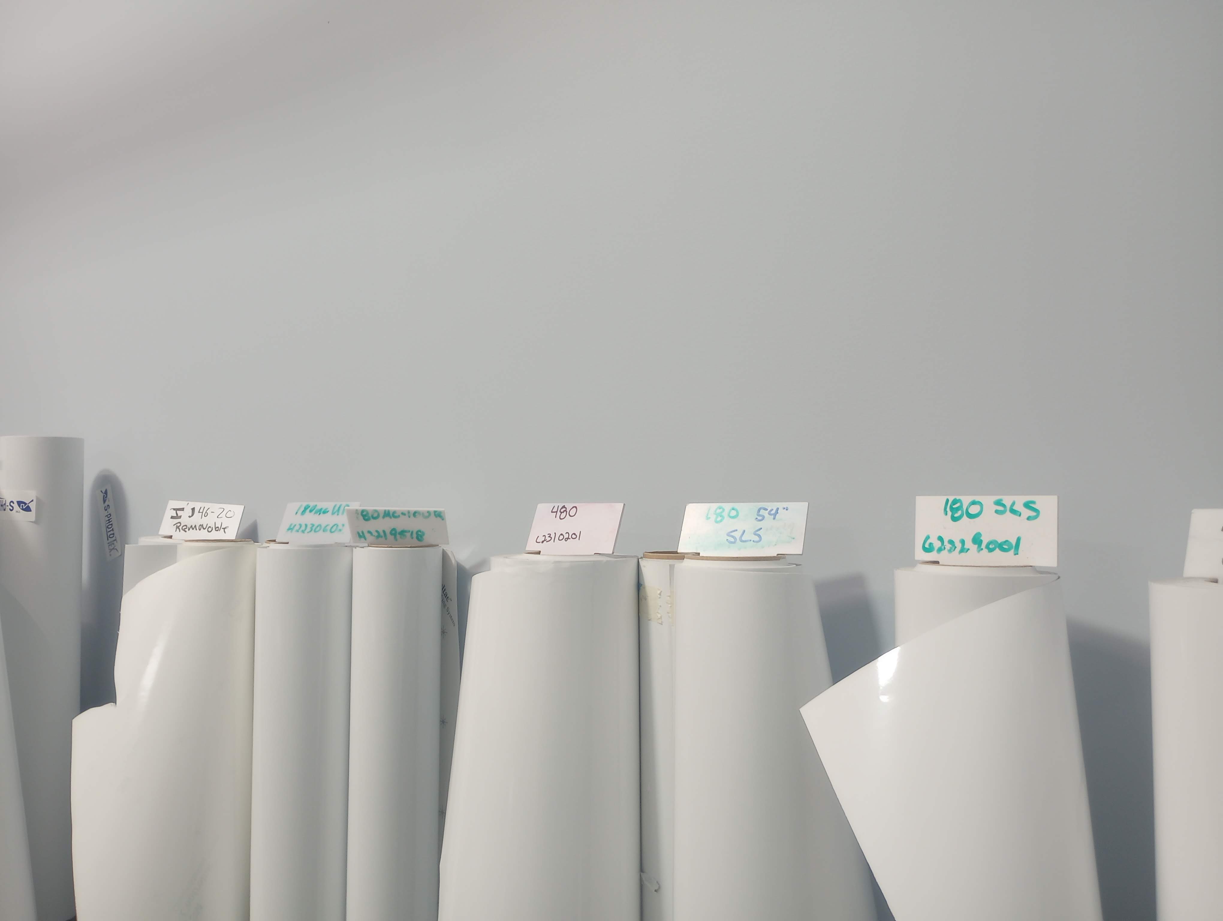

We gut little "T" shapes out of scrap plastics and use a dry erase marker to label every roll that arrives. We have to keep track of lot numbers on every order/print for MCS stuff so it helps making that easy to find. When the roll goes on the printer the T goes into the back of the RIP's monitor to show you which printer has which roll on it.
Since my old post got deleted, hahahaaha! Your coworkers are jerks for surrounding that bathroom. If it were my shop, at some point someone would line up rolls while the bathroom was occupied... Once had a guy ratchet strap a door shut by tying the doorknob to a desk. The guy in the bathroom had a screwdriver on him and took the knob apart!
Boudica
I don't really have any coworkers. This is my responsibility. Recently I cleaned that up some. I'm almost down to what will fit on the racks.
