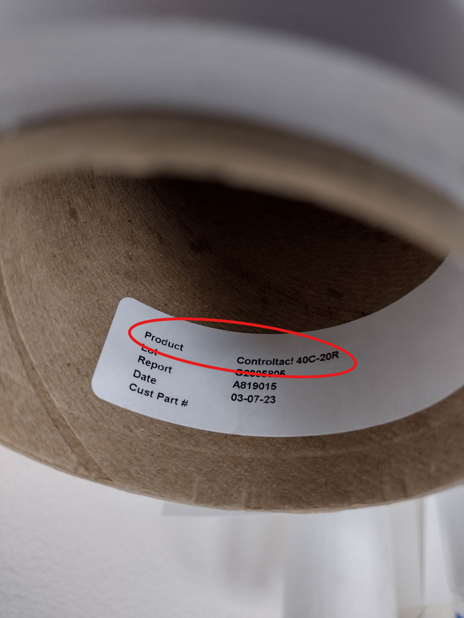

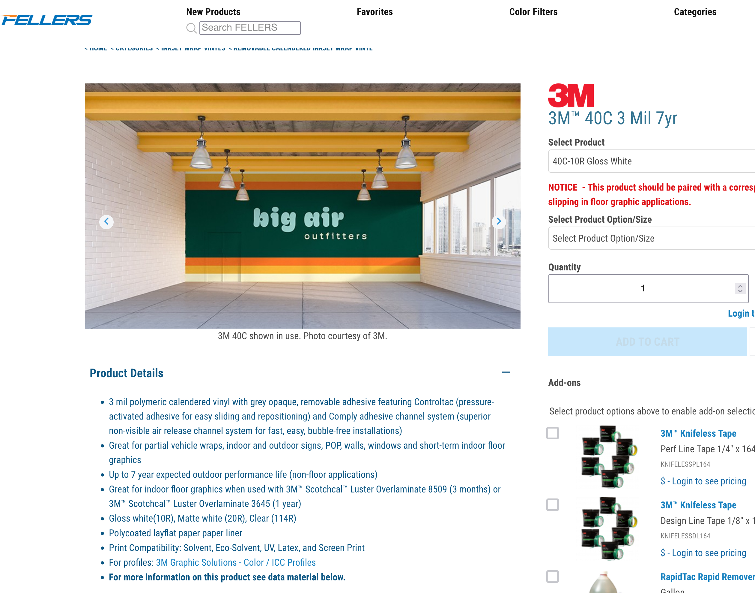

Most media has a label inside the core. If you're still not sure what it is from that, just go to somewhere like Fellers who sells most common vinyls and enter the product number in the search bar. From there you can get all the specs, sell sheets, etc... Like this.

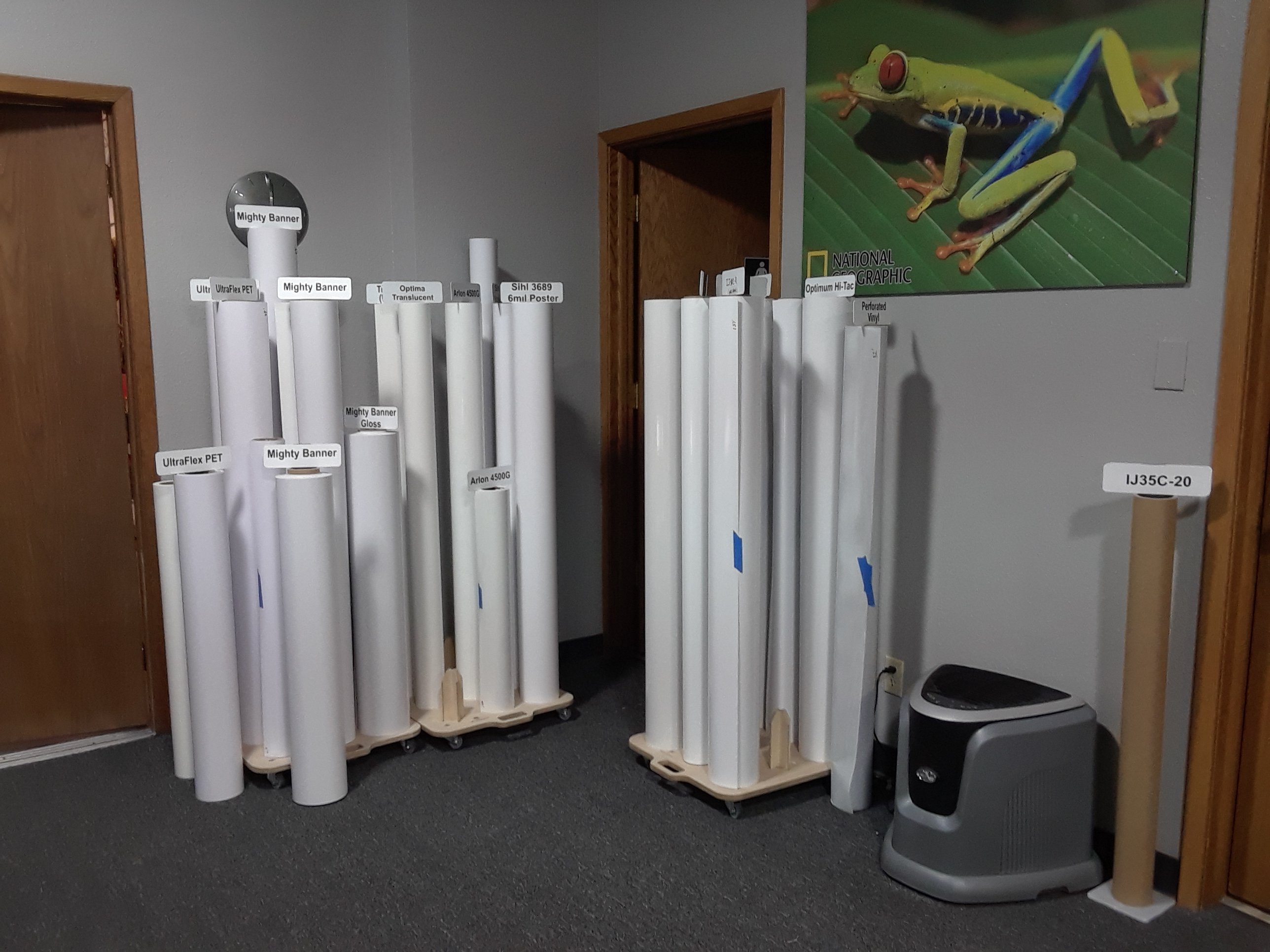

I make media markers. a piece of .060 HIPS for the "sign" and I use banner tape to adhere that to a "stick" made from ultraboard or foamcore scraps, approx 12" long by about 1.5" wide. I put those in the core, and when that roll is in the printer, the marker sit's in a short core that I have sitting between the two roll-to-roll printers. We all know what media is in the printer. Here is an older image, when my short core was sitting next to the media.
