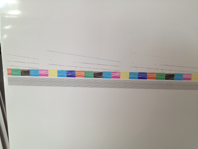

Hi,
I posted some pics of my printhead and I have already dones the coffee filter on the head to soak and ran about a billion cleanings.
Someone suggested ultrasonic. Which one do I get? Harbor frieght has one for about $30.
Also do I just put enough fluid in to cover the bottom of the head and hold it there?
And finally can I make my own cleaning fluid? Someone also suggested this?
Thanks in advance for your help!

Buy a cheap-o jewelry cleaner (stainless steel basin is required). Put a half inch of flush at the bottom and give it a couple cycles. Don't let the bottom of the head touch the cleaning tank.
This procedure works best on UV heads. I've tried it on a DX4 with no success.

I put about 1/2 inch in it and hold the head in the solution while its running?
Sorry for so many questions... I just don't want to screw it up!

I used my Harbor freight ultrasonic cleaner last night. I put about 1/4 inch of cleaning fluid in bottom of it and placed head directly on bottom. I now have almost all of my nozzles back working. I am thoroughly amazed. I had been missing 20-25% of my black for a long time and one single nozzle on Cyan. All C M Y are there now. The black is probably less than 5% missing now. I almost want to do it one more cycle. I did it for about 45 seconds. I have too much printing to worry about it.
