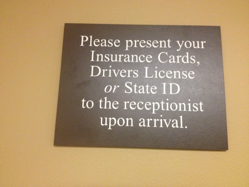

Hello guys & girls,
What substrate do you think this brown material is and what supplier can I find it from? Do you think the white is vinyl, screen printed or engraved? Thanks in advance for your help!
JERHEMI
Any ideas where to find this material? The white looks like vinyl, but that brown substrate has me stumped.
Rick
Looks like a phenolic panel/sheet to me. Especially if it looks like it has not been painted.
Rick
One would hope that's Micarta, but looks more like some off brand.
I looked up Regal Plastics and US plastics and they have similar panels
but you might have to get samples to match.
