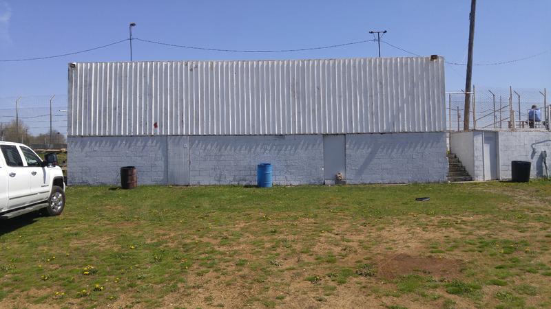

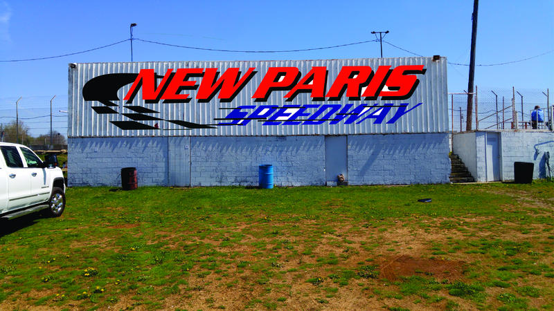

Our local racetrack whats to paint the back of one of there grandstands.. i suggested wrapping and framing with a banner or lots of substrates, but they are dead set on painting there logo on there.. I told them them that it might not work that well etc. etc. So if you were to apply paint mask or any vinyl to use as a paint mask; I was looking at Oracals "grey" paint mask. How would you install it on this corrugated metal. Bridge and heat in or install in every corrugate. The corrugate is .5" deep. or would you do something entirely different.. Just doing the logo as big as possible.. Attached is a rough proof.. I also thought about riveting .040 up there

I am doing a paper pattern for for the track walls and pouncing that.. just didnt think that would work well on this.
wouldn't use a mask.
pounce, project, grid
all three are easy for a painter
^^ That's the ticket. ^^ Half inch is nothing.
Some things just need to be handled in the correct fashion and not take an easy way out, which will probably produce unfavorable outcomes. :covereyes:
since corr is only 1/2" pouncing should go quite well, would probably just need to 'finish off' some missing parts after pounce.
would be MUCH easier than trying to lay mask (and the mask would most likely fail and you'd have under-running etc.

Mask and paint is actually not difficult on corrugation
This is an easy job if all you need to do is supply the client a pounce pattern. The pattern will transfer easily to half-inch corrugation, especially if they use a loaded pounce bag. Any competent painter can follow the lines.
It would be interesting to see the job after they finish.
Hand lettering corrugation is easier using brown fitches. They are softer than a normal bristle fitch and are great for metal corrugation. These brushes are sometimes called 'speed fitches' or 'blitz fitches.' They are for oil based lettering colors.
I have lettered lots of corrugated metal over the years, mostly semi trailers, both by hand lettering and by mask-and-spray.
I would never attempt laying a vinyl mask, but using liquid mask and spraying with automotive colors results in high quality, long-lasting sign work. The mask is applied with a thick nap roller, two coats minimum, and easily covers corrugation. A pounce pattern transfers well and knifing is easy. Adjoining colors can be applied by masking, spraying, then re-masking, re-cutting and spraying additional colors. The maskant does not harm fresh paint.

If it is really a short term idea. Then, a banner is their better bet. BUT. I know how these kind of people think. And their "short term" idea will be up there for decades. Also... you should re-design so that the red and black are not touching....It looks bad.
