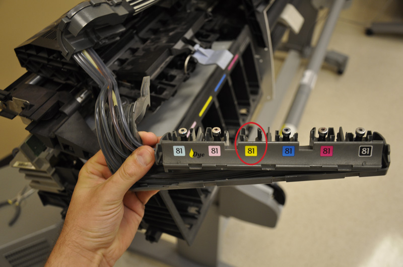

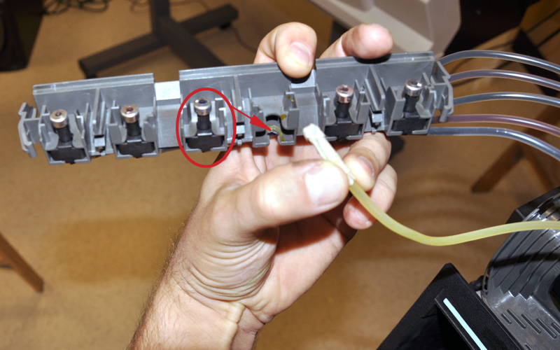

Found the problem. Its where the yellow ink tube ends and plugs into little black plastic nipple (yeah, I said nipple) with a chrome metal cap. ok, I dont know what its called but its circled in red. See pics. This plastic piece has a 90 degree elbow that inserts into the yellow ink tube. This elbow has cracked off and was stuck in the end on the yellow tube line. Now, my question is, where can I get this little plastic piece or am I stuck with buying the entire ink tube assembly (part# C6095-60186)??? ...and where? ...and how much?
Can anyone help a brutha out?:cool:
Thanks
