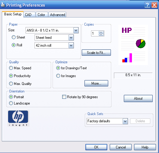

I have 5000 not the PS, if I use the print drive I'm offered Max Quality, Productivity, and Max Speed. These correspond to 1200x600, 600, and 150. Same if I go through Flexisign. Are you sure you have the drivers installed correctly?

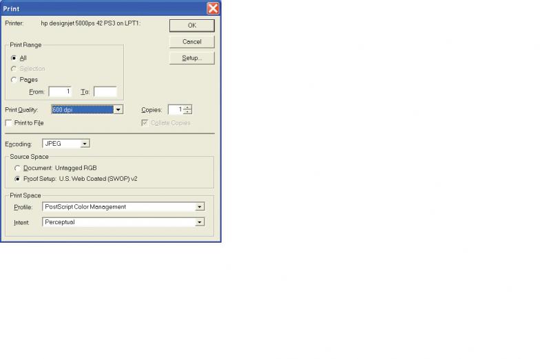

thanks for your response. I am using adobe photoshop to print, and when I go to print options it only gives me 600 dpi max. Do I have to use a sign software to get that option available?

600 dpi max
I tried setting all the media types, but when I go to the print options it is at 600 dpi max. Thanks for everyone tryin to help.

Please click on the link to view the screen shot. Thanks
C:\Documents and Settings\Chris Ramos\Desktop\hp 5000ps.bmp
Famous Ramos
600 dpi max
Sorry about that. Here is a picture of the print options.
thanks. Chris
Artildawn
Yeah, I definitely think your drivers aren't installed properly, but can someone with the PS version verify this? Here is what mine looks like:

I have the 5500ps hooked up tcp/ip through ethernet.
Pretty sure you will want to hook it up this way.....it rips and prints much faster.
You do need a different driver.
It's been several years since I installed mine, but I remember having a
driver installed with minimal settings like you have, before I found the right one.
Mine is similar but different from post #12, and has several print options.
It doesn't have a media type in it either.....that is selected at the printer.

I have installed and uninstalled drivers and still can't seem to get mine to have the print options like #12. Does anyone have the correct driver for this HP 5000ps, I got the updated firmware but I can't seem to install it in my machine. thanks for everyones help.
