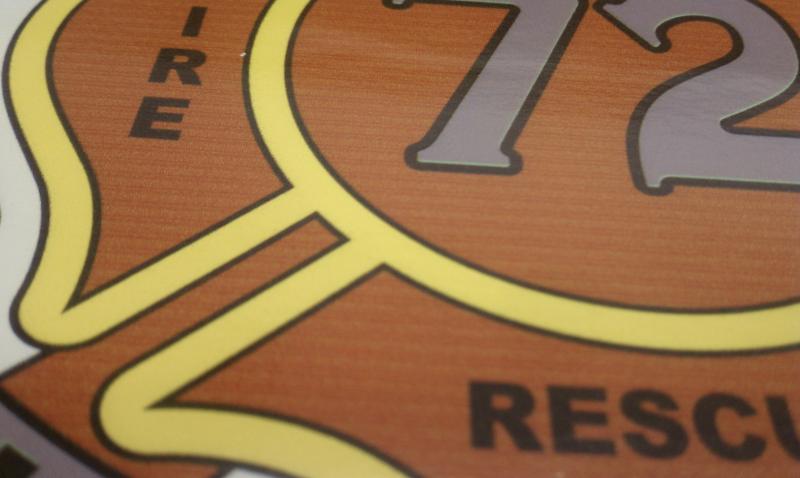

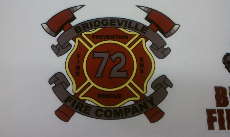

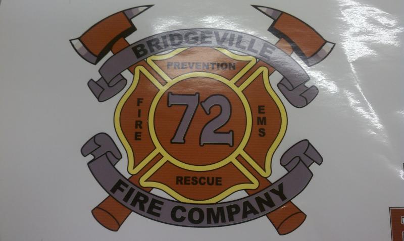

i took a few pictures just to give you an idea of what we are dealing with. the first two pictures are the red image printed at 8-pass and you can really see the banding in the first image. the last image is the the 16 pass/overprint 2 test image. as you can tell, the last image actually came out how we wanted it to and had no banding whatsoever.

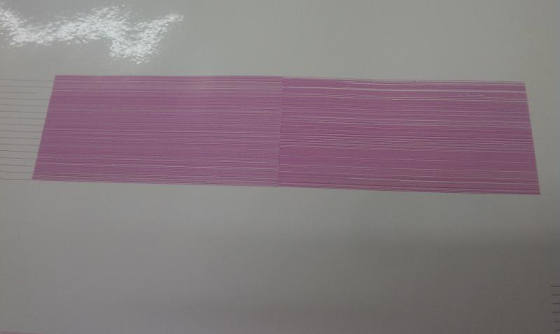

i did run the nozzle check earlier this morning when i brought the printer online after it had been soaking for an hour or two. i'm not quite sure what i'm looking for but the banding in the magenta image that is attached can't be good.

Have you tried HP's cleaning/soaking pads? Head Cleaning Kit Q6665-60089 Rev A
The pad is lightly satruated with cleaning solution and than jammed against the print
head overnight. I've had very good luck just using it occasionally when needed. Give Advantage Sign Supply a call.
d fleming
If you can do a clean and get a good nozzle check that then as you print goes bad, you have an air leak in the system. If system is tight and this nozzle check looks the same time after time, you most likely have a head issue.
Typestries
Agreed it could be an o-ring. Also check the magenta cap. It may not be sealing, or may be clogged, follow that tubing down to the primer pump and check that too, could be worn or clogged. While you are at it, leave those covers off, it makes troubleshooting this much easier in the future.

we are printing 6 color in 720p mode and we are using PosterShop7 RIP. The color management in PosterShop7 is setup for custom and when you go into the ICC Profile setup the values, from top to bottom, are Default CMYK/Default CMYK/Default RGB/Default RGB/No Profile Selected.
the pictures were taken of a print done on Avery NPI 3100 vinyl. The first two pictures were done at 720p 8-pass and the third picture was done at 720p 16-pass/overprint 2. we see the banding in the reds on all media types but see it the least on banner material.

it turns out that it was a faulty magenta head after all. had a guy named dave mulkey, who works for jet-tech, stop by on friday and check it out. definitely a super nice guy that knows his stuff. ended up changing the magenta head and a few others things and there is absolutely no banding at all in our red ink now.
