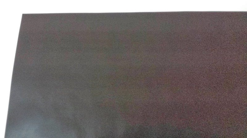

Here is the picture at 8pass printed on vinyl. The camera don't show it up verry well. There is more banding at the startup of the print than the end of it (12inX12in square). Oh, and the test prints (test plot) are perfect.
