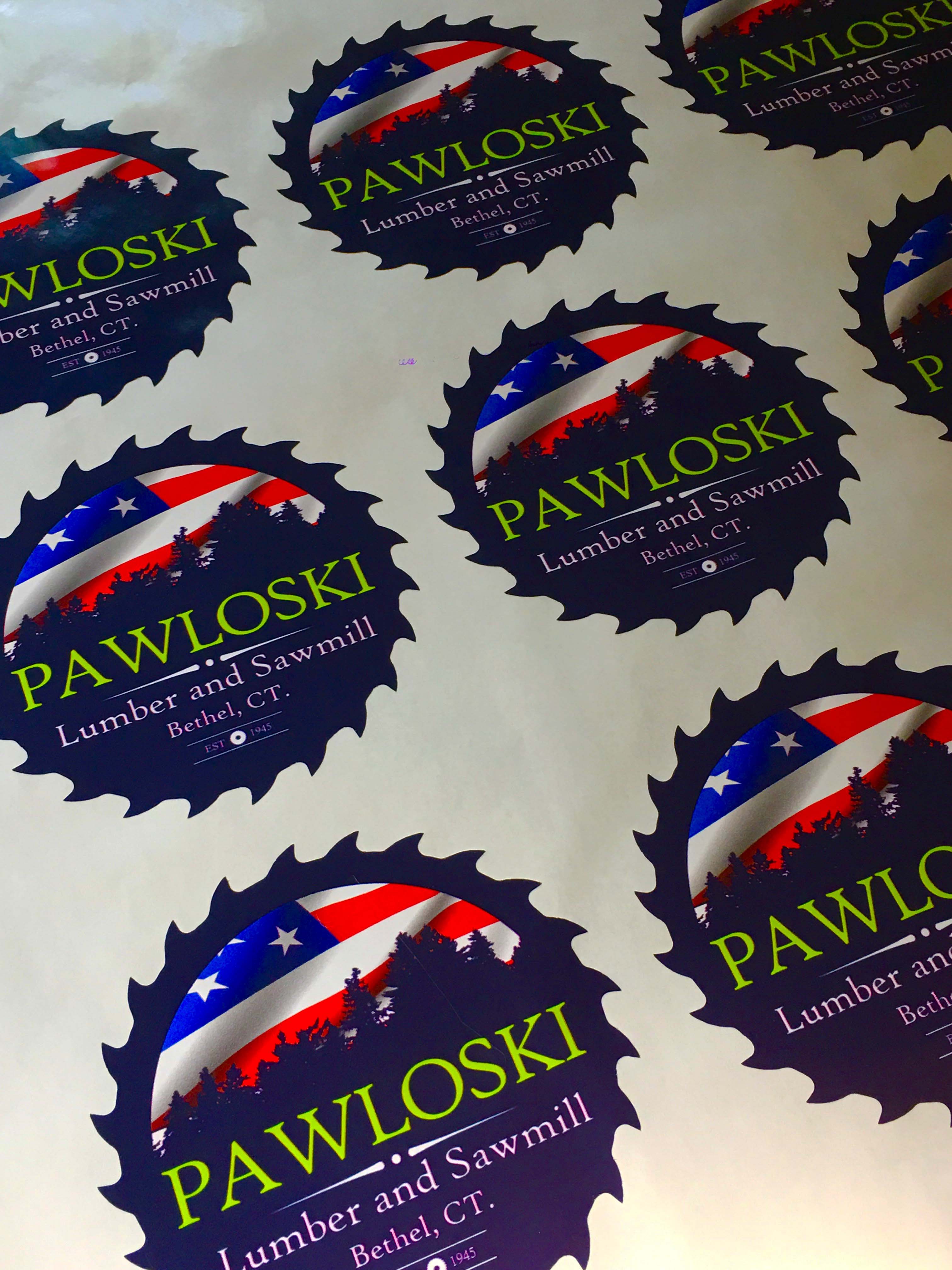

So after some cleaning and a couple of parts were up and running and seems to be printing great. Another plus was we discovered there was still warranty coverage on the machine. Thank you again to those that chimed in w advice on this. Next, keeping color between the monitors and printer consistent? I'm going to purchase the X Rite I1 Display pro. Any suggestions appreciated on how to manage.
