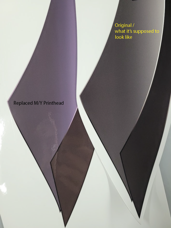

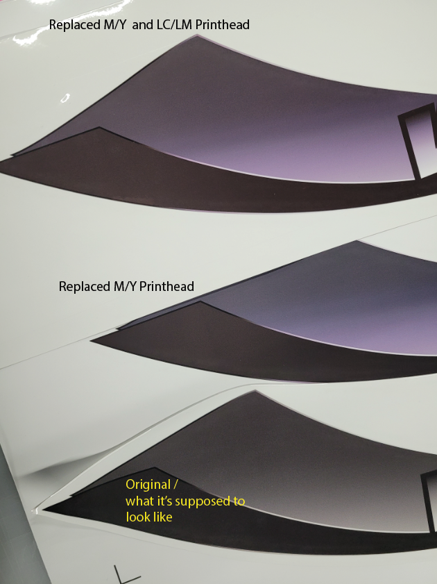

Hi guys,
I'm really hoping I can get some help here before I have to call HP or explain to my boss what's going on. I'm honestly at a loss and feeling really frustrated by my lack of knowledge about these large format printers.
I replaced a C/K and both M/Y printheads yesterday after noticing a print job had an off-color. However, the print still came out sort of purplish compared to the original (see photos). From my past experience, this was fixed after I replaced the LM/LC printhead so I went ahead and replaced that one as well. Almost all of the printheads have been replaced as of today except for one of the C/K printheads. I ran another sample and it still came out too purple.
I've cleaned the printheads several times and have run several printhead status plots. They're all working correctly. The inks in the printer have only been in there for a few months at the most. I haven't changed any of the substrate/color settings since the time of printing the original, so I don't know what the problem is.

hhg98
Hi guys,
View attachment 175472 View attachment 175471
SOLUTION:
I got in touch with the vendor that we got the printer from and they were very helpful. I sent him tons of photos showing that the printer, printheads, and inks were all in good condition. He said that in rare cases, the print profile could become corrected. We were printing on 3M 1J180mC-10 and using the corresponding print profile. The rep had me download 3M Controltac IJ180C v6. I printed the sample again and it came out much closer to the original this time. The colors look much better now. They are not 100% the same, more like 99% the same. I think for the majority of clients, any potential color mismatches won't matter. This particular client is super picky though, so I decided to see if I could fine tune the color more. I ended up adding 6% magenta to all of the gradients to remove some of the green that remained. After I did that, the grey tones looked much more neutral and almost perfectly matched the original graphics.
TLDR; Our print profile got corrupted somehow and caused the colors to be off. We downloaded another 3M profile and tweaked our colors slightly to get it to work.
