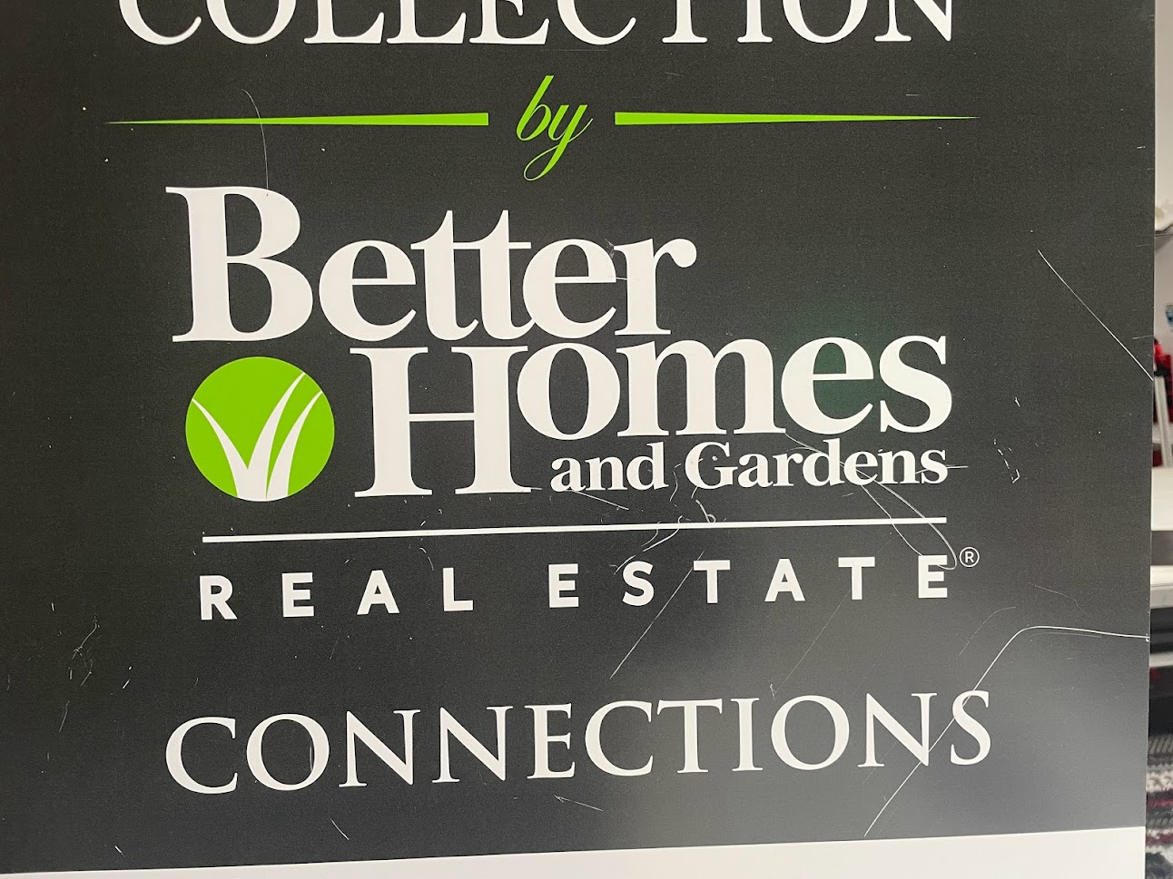

Hi everyone,
I bought this R1000 printer almost 3 years ago now. It has been great but I have been noticing that the prints have been scratching very easily. What I mostly notice it on is the real estate signs I print. I use Maxmetal Digital Print ACM. I almost always do double sided prints (real estate signs). I am very careful with prints and try not to drag and handle them with care. I take them off the printer and bring them to the production table to trim and find that there are a bunch of scratches and wonder how the heck it happened. The ink just scratches way to easily. I even tried to clean the panel with Denatured Alcohol before the loading, but it doesn't help with the scratches. Just feel like I am wasting time doing it.
I realize it may be because there is some type of sharp object on the production table giving it scratches and I often clean or blow off the table before putting signs on it. But I am also having my installers say that dark color inks such as black being the worst. He says that if he has two sign panels that are wet back-to-back the entire print gets ruined from the water. With a printer of this price, I wouldn't expect such a failure. I would really hate to have to laminate every panel to avoid this. Even if I did there could be scratches before I laminate the signs.
What am I doing wrong?
I modified the profiles with different variations but still no luck. Anyone have a good profile or suggestions?
Brandon

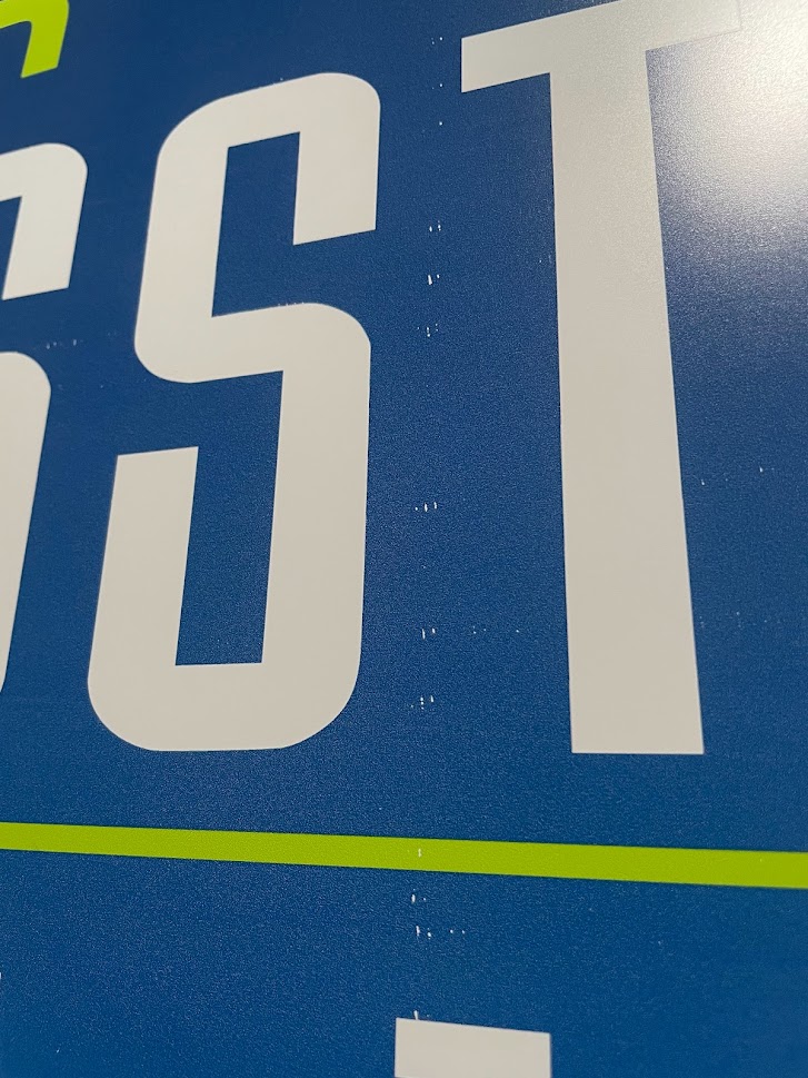

I am also getting scratches when I print the second side from the belt.
With ACM I have noticed that I have to let the substrate cool down to reload unless the print doesn't print correctly due to the ink drying to quickly in the print zone.

Regarding the „scratches“ on double sided: these are not scratches from the belt. It’s the vacuum sucking partially ink from A-side. Try to reduce the vacuum as much as possible.
Scratches during handling can happen easily, since the ink layer is much thinner compared with UV. Lamination is necessary in this cases.

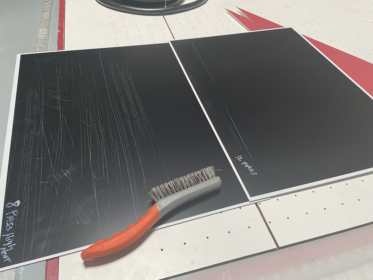

Brandon708
UPDATE
After going up to a 12 pass the ink is holding up much better. See attached for the photo that I scratched equally with a wire brush, 8pass vs 12pass. It takes much longer to print but the end product is much better. When I first got this printer, I thought I can print in 3 or 4 pass for real estate signs and pump them out quickly. So, I have went from a 3 pass to 8 pass now to 12 pass. 3 pass to 12 pass takes 4 times longer so that sucks. Other than the scratches it has been a pretty good printer, just doesn't print as fast as I would like. I also wish the overcoat was a true overcoat with a harder thicker protection.
I also learned quickly that you can't print one side of Aluminum and then reload it right away. You have to wait till the sign panel cools down to room temperature to reload it which really slows down small runs. It's almost like you printing 1 double sided real estate sign (2'x3') takes almost the same amount of time as say 6 double sided signs because you have to have that one sign waiting for it to cool down. But when you have say 10 double sided signs the first set is already cool by the time it's time to load it.
I am open to suggestions to another flatbed printer that has a better adhesion and durability.

You could still try 8p with 1.0 or 1.5 OC. I think part of your problem was that excessive OC that won't let the ink dry properly.
I don't even know why they allow to set it at 3. It's just stupid much.

Brandon708
Is your scratch test a 'wire brush' ??
For this test yes. I am lightly scraping the surface. Do you know another method for a scratch test? I realize it's a pretty aggressive approach, but you can tell if the ink is coming off easier than it should by brushing over it lightly.
Well, if it works go ahead, but I wouldn't use a wire brush. Usually a fingernail will suffice. Heck, I wouldn't put a wire brush to anything painted or printed. Sounds like a disaster on purpose.
May I ask, what trimming are you doing that you need to cart a 1/2 printed panel around the shop ?? Reason being..... the more you handle it while somewhat uncured, the more chance of anything happening to it.
Those scratches look like you have little stones or shrapnel on your tables. I also don't understand how WATER can ruin a sign from just getting wet ??
Maybe I'm misunderstanding, but this is direct printing to the substrate, correct ?? You're not printing vinyl and laying it on one side at a time ??
When we have delicate signs needing to be flipped over, we Have thick carpeting we lay down and we still make sure we don't slide it around.

Lots of good answers, fought this for a while until creating a profile for the 2nd side with lower temp and slightly less vac. Always thought 2nd side was scratching until we realized that what was really happening was that the ink on the belt was heating and pulling ink off of side A, much happier after creating that second side profile!
