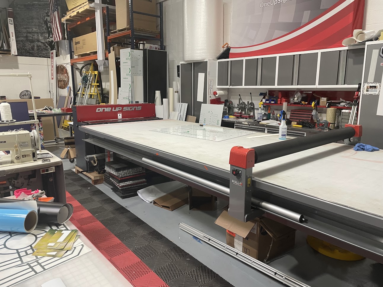

Maybe I was miscommunicating the process for us.
-I start with trimmed blanks that we cut
-Load the printer and print one side
-Take the printed sign and reload for side two
-Take the sign to trim if needed (phonematic shear red thing in the photo that says One Up Signs)
-Round corners
-Add grommets
I am very cautious about these panels not getting scratched and handling them with extreme care. I do blow off the table and shear when I have a printed sign to trim (usually only signs with full bleeds that don't fully bleed) Usually trimming off a 1/16" from the signs.
The grey Better Homes and Gardens sign I notice was scratched when I was putting on the grommets. Not the only time it happened just made me ask for help on fixing it.
As for the signs getting wet situation it happens when a sign panel is wet and they are two that are put together. The water and rubbing together turns the signs into water color painting. Imagine a installer getting a real estate sign panel that is wet and laying it on another sign panel. That is when it happens.
I will try to recreate this with the old sign panels I have and post a photo.
Don't know if others do this, but we hand clean our table tops when putting signs on them, especially freshly printed ones. Forced air cannot do it alone. That's why years ago, everything got tacked down 2 or 3 times in different directions.
About the only time we're somewhat careless, is when the masking is still on the blanks.
As for the water problem...... I don't think I've ever heard of water reconstituting already dried inks. How in the world do they hold up against rain or ice or some kid with a water pistol ??
Nice setup :thumb:

you're right about the air not being enough to clean the table properly. I have to do better cleaning the table.
Thanks!
