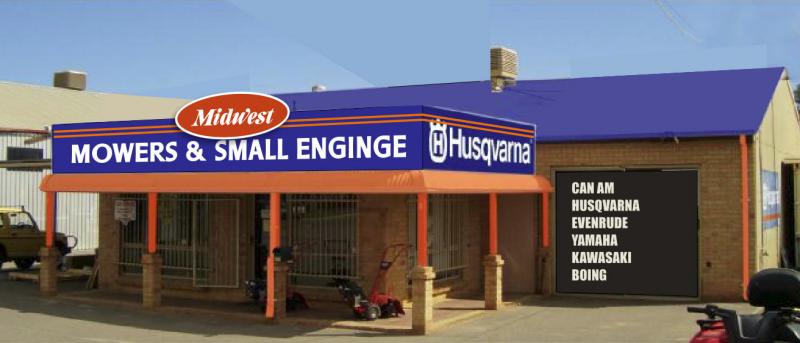

Try Mowers & Small Engines in caps and l/c
Eliminate the gradient boxes and center MIDWEST, make orange rule lines on either side of that.
All-caps can be hard to read.

What do you mean by rule lines Jill? Something like below?
I still havent receivied a email as too wether I can go a lil further with the layout but once I get an answer either way they still have to approve it before it goes ahead.
  • Building Facia MWM.pdf

Try breaking up the straight roof line and improve your contrast. I still think there are too many signs on the building. You have Husqvarna on the sides and don't think you need them on the roof.
I'd put the manufacturers names on the two glass windows below as a list. Clean and to the point is better than just plastering names all over the place.
Contrast is a wonderful thing in a bland world.
Notice I used the Australian spelling for engine!

Love the layout Bob!! I like the spelling too!!
The only thing I have any say in though mate is the front sign, the rest is what Husqvarna want!

I could write a big long winded reply but in short that's what the client & rep want so that's what they will be getting....
Over it, just going to nod, do the job & get payed.
