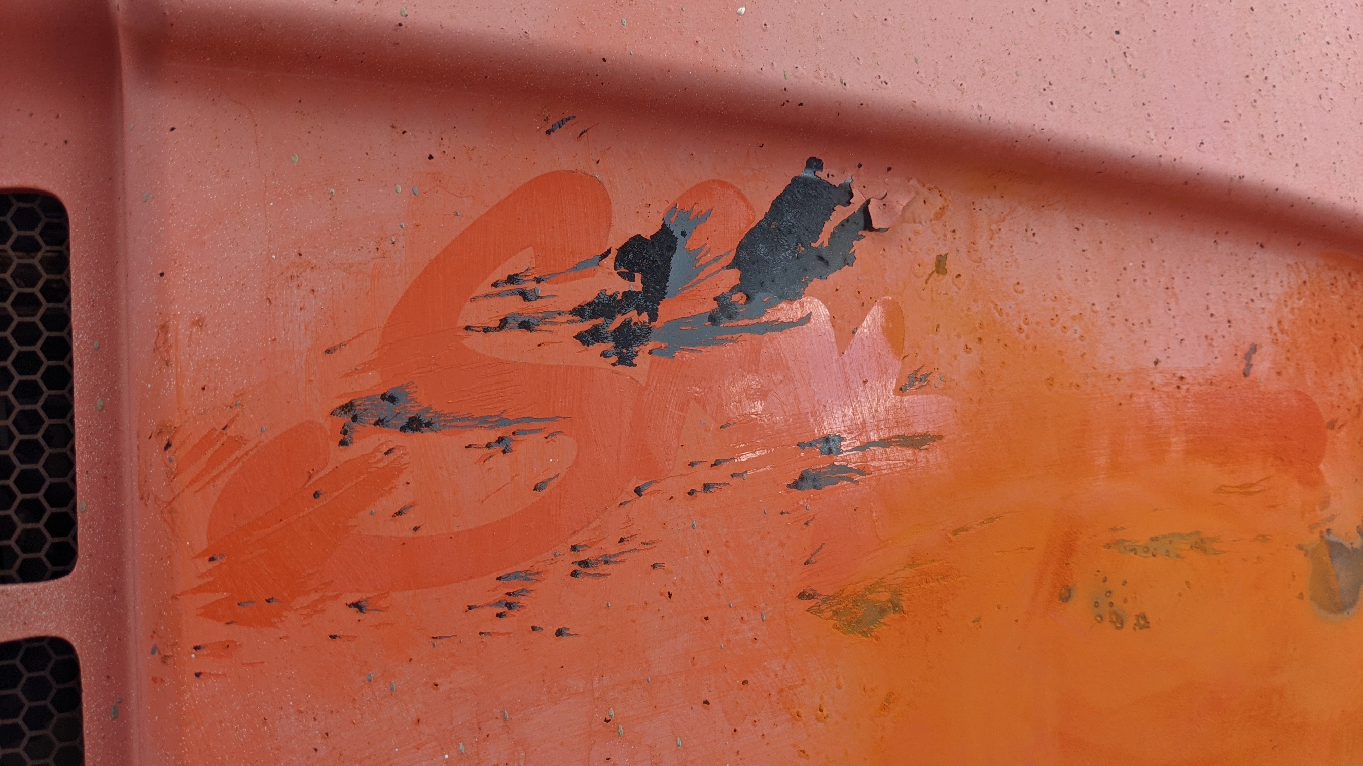

This is from yesterdays decal removal with a pressure washer. Takes the paint with it. I'm not saying a pressure washer can't damage decals because they obviously can but multiple vehicles and all of them peeling from the top? Seems more like gravity and material failure working together.
View attachment 167634 View attachment 167635
That's not car paint. Heavy equipment and trailer paint comes off with orange peel.
You gonna try to school me on paint now too? You realize that I own high volume industrial paint business and run 500-1000 jobs a year through here right? 1/2 of that is trucks and the same paint is used on them as anything else, Imron.
unclebun
Not the dozers and things we have to deal with. Stuff is soft, chalks, comes off easily. I've never had a pickup or car do that unless it's one with all the clearcoat gone and 20 years old.
Did you miss the part where I said we paint trucks as well? We paint for the dealers, color changes on new trucks for manufacturers, cars for friends, new garbage trucks, new vac trucks not just used stuff. The paint comes off all of the last generation superdutys and all of the mack granite doors with a pressure washer when you use them to get the decals off. I can keep posting pictures because I see it constantly.
As for machinery, what we use is not soft, it doesnt chalk for years and it does not come off easily.
