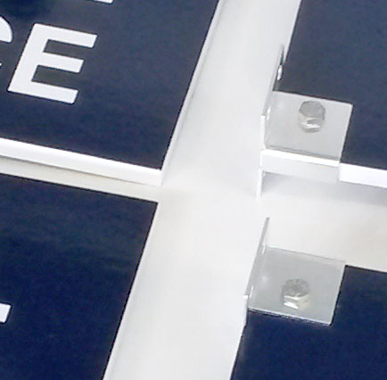

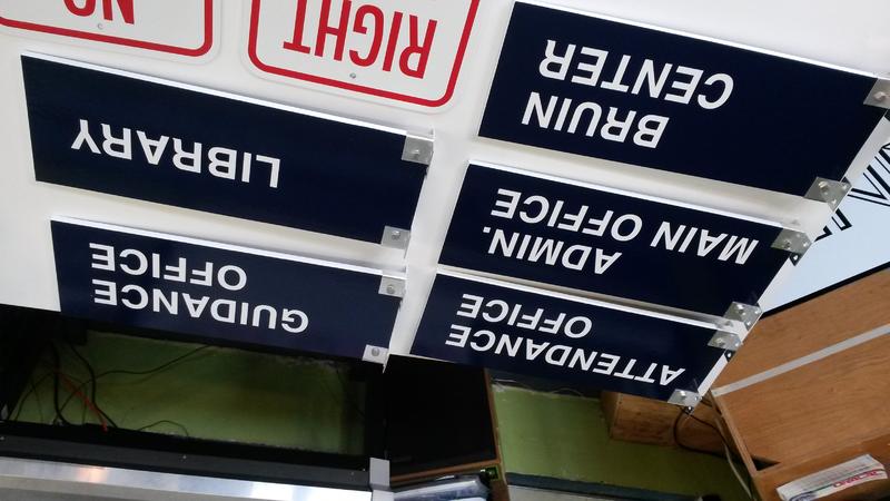

Up late, just finished some MDO signs. I think they look pretty solid. Double sided, just vinyl on MDO with some corner brackets. 8" x 22" hoping to get $96 each.
Question being, does anybody else paint the edges after applying full bleed vinyl? I think it looks great, but I don't see it very often. Even if the vinyl shrinks, it will create a nice "feature stripe (border)" of the white substrate.

Apparently the forum downsizes uploaded images. Hope this one has some detail...

If what you say is true, that you like crisp edges, why not do it in a fashion, that you get your wish ??
Why not paint the panels navy blue and apply white die cut vinyl ?? Never hafta worry about shrinkage, borders or longevity. This procedure will last near 10 years for less time and money, let alone a better product.

Plus i guess its for inside anyways, so yeah, will last forever

the white edges aren't nearly as much of an eyesore as the unpainted brackets
edit: and "hoping to get $96?" did you not quote before manufacture? I don't get it.

My guess is they're prototypes or tests and not for an actual client or job. A proof of concept or whatever you want to call it.

less then 4 sq ft sign for $100? $25 a SQ FOOT......... nice if you can get it.....
dont like the white edge......why not same blue as face? for good clean edges.....and longevity.....i woulda taken the boards painted gloss white, applied the lettering in vinyl mask, painted the boards blue(edges also)removed the vinly mask.......wala......an all paint sign.....that will never shrink)))

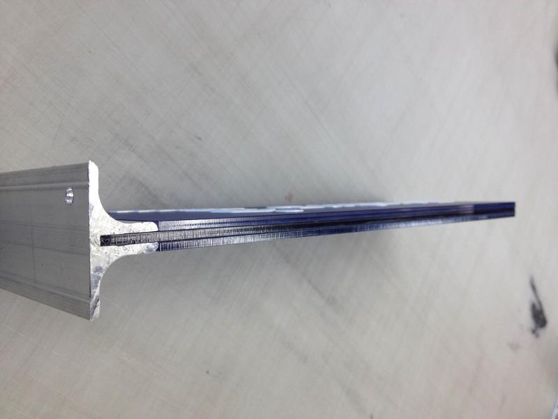

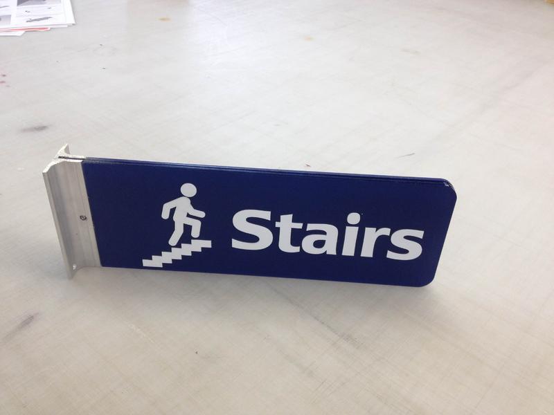

I agree about the white edges. Here are some that we recently made, it's 3 pieces of p95 acrylic, reverse painted, with raised ADA lettering on the face (not required, but I think it looks nicer than vinyl) the middle piece is 0.75" longer than the 2 outer pieces, to allow it to fit into the bracket, we drilled and tapped a hole through the bracket and acrylic piece and put a set screw in to hold everything, i don't like exposed fasteners on my interior signs if I can avoid it.
We got around $165 each for the signs.

I agree about the brackets being fugly. I would use an angle the full length of the sign, similar to what Watson did. Then leave aluminum or cover with vinyl.
You can add a little length to the sign for what will be hidden and center on what is visible.
For dark color backgrounds I use black PVC. No need to paint.

+1. I would have done the same, or just painted it and used white hp vinyl.

All that matters is that you and your client are happy. Personally, I'd recommend going to 12/13mm white PVC/Sintra instead of MDO. Although the material is a bit more expensive, you're production time should drop a good amount, especially if you needed to do a decent run.

My opinion is the project is flawed because front surface vinyl signs in a hospital setting are going to fail earlier due to the constant cleaning. I would recommend engraving, applied letters, or 2nd surface vinyl. But that's me and my business. You can do what you want and in the end, really all that matters is your client is happy and you're providing a product that is well made, well designed, and you stand behind your product. I could rationalize why my method is better, but in the end, if the customer doesn't like it, what's the point?
Second, Sinatra has no lead. http://www.substratum.org/wp-content/uploads/2013/02/Sintra-MSDS.pdf Sintra is PVC.

The Vinyl Covered Mdo Signs and Brackets are Very Nice and I'm sure they will make a Customer very happy at $96.00 each.
