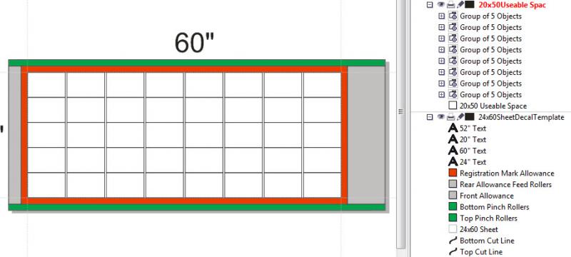

Get a used Graphtec CE5000... Get your stuff printed on 24" wide material. I use 60" wide material but print 24x60 sheets for contour cutting small decals. If you can afford it get a 36" FC Graphtec.
Gang up your art into 24x60 sheets (allowing 5-6" in the in the back so the sheet doesn't fall out of the cutter!) and some space for pinch rollers, and then space for the registration marks. I budget 20" x 52" (on a 24x60) sheet as useable art space. Gang up as many of your 4x6 things in that space as you can.
Using my system I would get 40pcs from a 24x60 sheet.
This is a 66.66% sellable yield. I use 10 sqft of material, and get 6.66sqft of decals.
210 Lam only comes in these sizes: 30", 36", 50", 54", and 60". I stock 36" because I sell alot of 24x36 stuff too, but for your decals I would use a 36x55 swath of 210 and trim it down to fit the 24" sheet (3651, or 3165RA)
So, I get a paltry 48% sellable yield on lam. (I have a big bucketful of 12x60 210 lam scraps!!)
With my 24" plotter I can yield 40 pieces of a 4x6 decal, which consumes 10 sqft of vinyl, and 13.75 sqft of lam. You can do your own math about what the costs are for that.
So, now when I quote this kind of thing, I have a minimum quantity of 20"x50".
I use an excel sheet that calculates the cost of the vinyl, the lam, the ink, and divides by the # of pieces in the useable area to get me a piece costs. Then another few colums that lists what the piece price would be at a given $$/sqft.

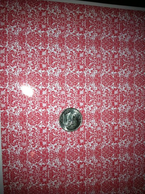

Here's a sample of a sheet before I send it through the plotter. I then line it up with my basic plotter and cut out the shapes (most are simple ovals).
I appreciate the help I've received and haven't tried to be too ambiguous. I've got a weird niche product that probably only has a couple months before everyone jumps on board so I've been trying to keep it fairly close to the hip. If I haven't provided enough detail I apologize.
Would a Summa be able to get this kind of detail?
