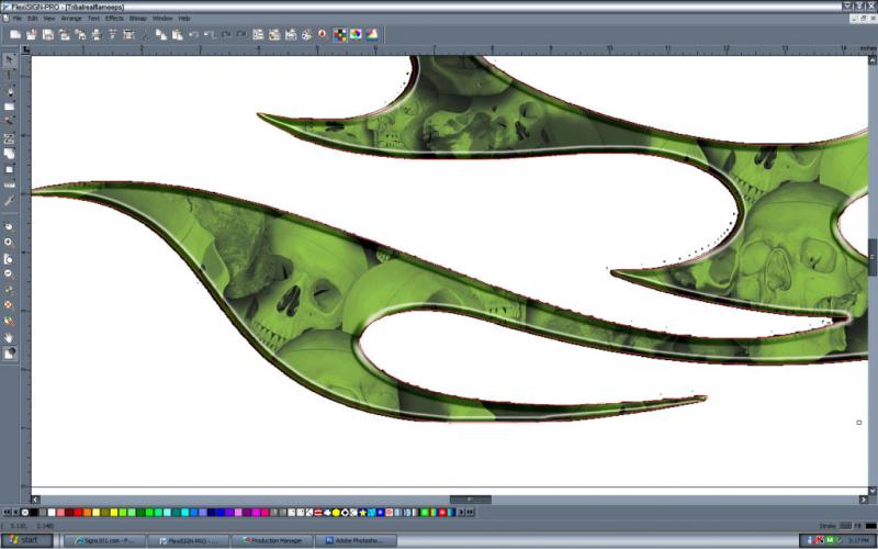

Using Flexi 8.6v2, I opended the eps, contour cut it, imported the image over top of the contour cut. When i go to cut it it tells me nothing to cut lol oh boy. below is a pic of what i have.

Off topic, but can I nit pick? I'd remove the line across the top of the skulls so they don't look so much like medical pieces.
DRPSignsNGrafix
More info may help. WHat printer cutter are you using? and to get the cut path to top, just select it then click arrange,order,to top

1 open the file u want to print. (the green skull thing)
2 Open the EPS cut file, place on top of Green skull thing
3 click on cut line, then click arrange, contour cut, make contour cut
4 click rip/print button
amgraph
Have you actually created a cut line under either effects> contour cut or converted a line under arrange contour cut make? You can also do >select by attributes and look under stroke. There should be a stroke named Contour Cut.

Ok, when i open the eps, it opens in a sepreate document. How do i get it into the green document?

No u should see the image as well as the registration marks
