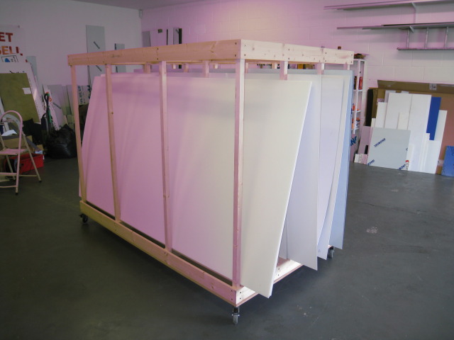

rack
ok, here is a real idea this time.

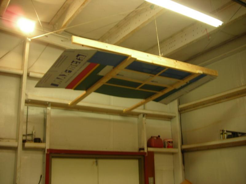

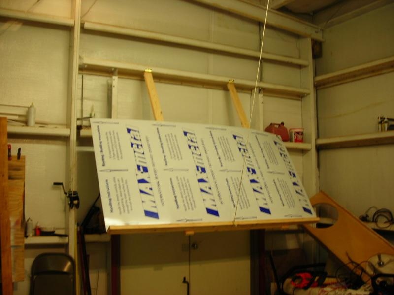

i posted this a while back............if you got over 10 ft ceilings works good. mine is 16 high side, 14 low side. this is on the lower end.

OP...looks good. If you don't mind that I make one suggestion. Place a 2x4 under the two that are supporting the substrate. As it is now, the weight of the substrate is on what ever is fastening (screws or nails) the two 2x4's to the one that has the rope attached to it.

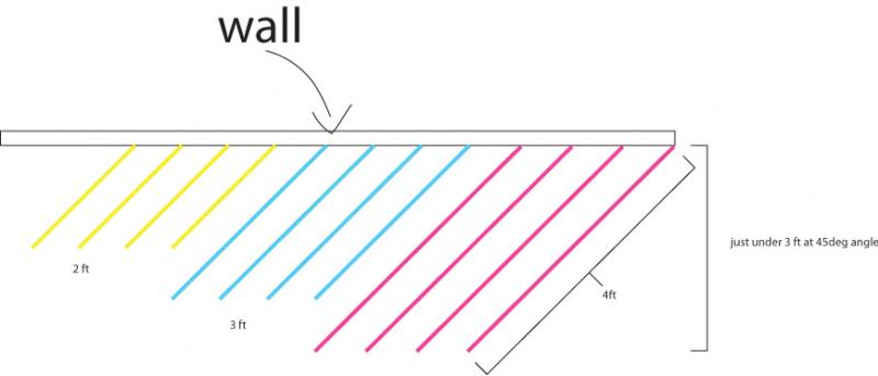

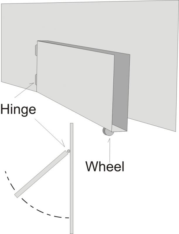

Here's something that I remember seeing in a woodworking catalog. Not exactly thorough as far as organizing, but I think I remember it for a small shop. The back part is hinged against the wall and the front part has a wheel attached to the bottom. Its ok for going against a door or a short wall where you can wheel it out and pull out the substrates and then wheel it back against the wall.

there is a 2x4 at the bottom!!!!!!!!!!!!
since the pic was taken, i have added a 2x2 4 ft up, and 2 more vertical lath one on each end, between the bottom 2x4 and top 2x2.

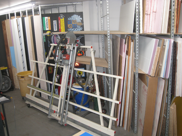

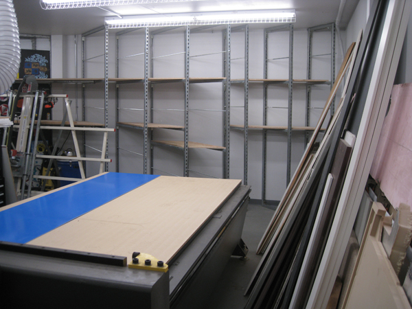

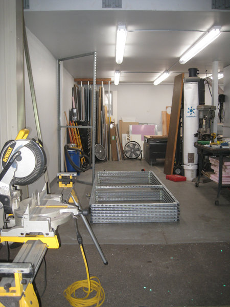

i think" isign" recently had some pics of some nice diagonal style racks for substrates. i think they were in a descending size order.
true.
Made my first one for 4x8's ...loved it, so I tore out an older one & made a second matching unit, but with shelves for cut down scraps...
