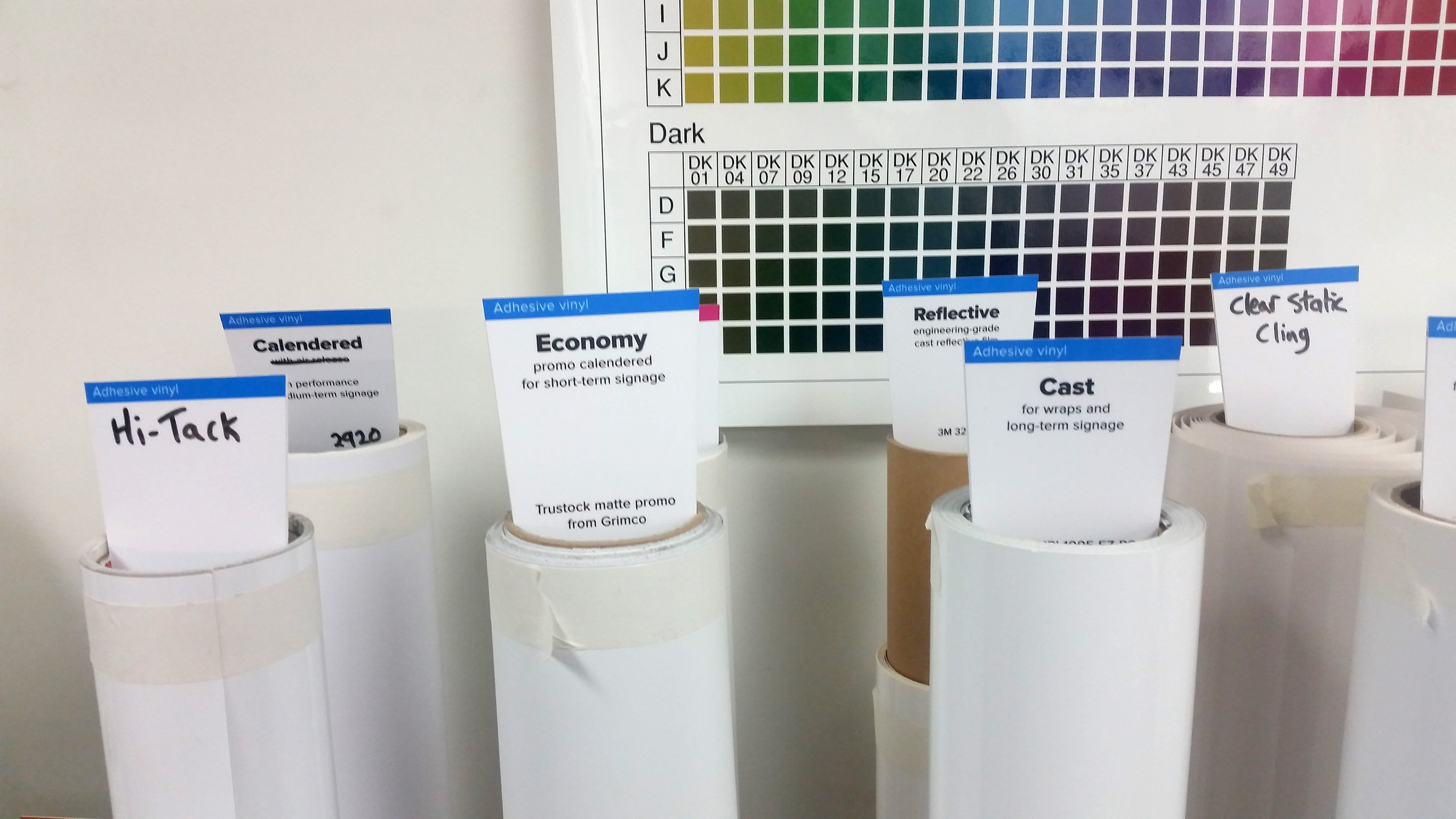

You don't need a CNC to make your own core ID cards. We print from a template, apply it to PVC, then cut it with a ruler. The left/right sides are at an angle so the top is slightly wider than 3" and the bottom is slightly less.
We cut ID cards out of 3mm PVC and apply printed decals to them to identify standard roll materials. We also keep a few blanks around for new materials that we can conveniently label with a Sharpie.

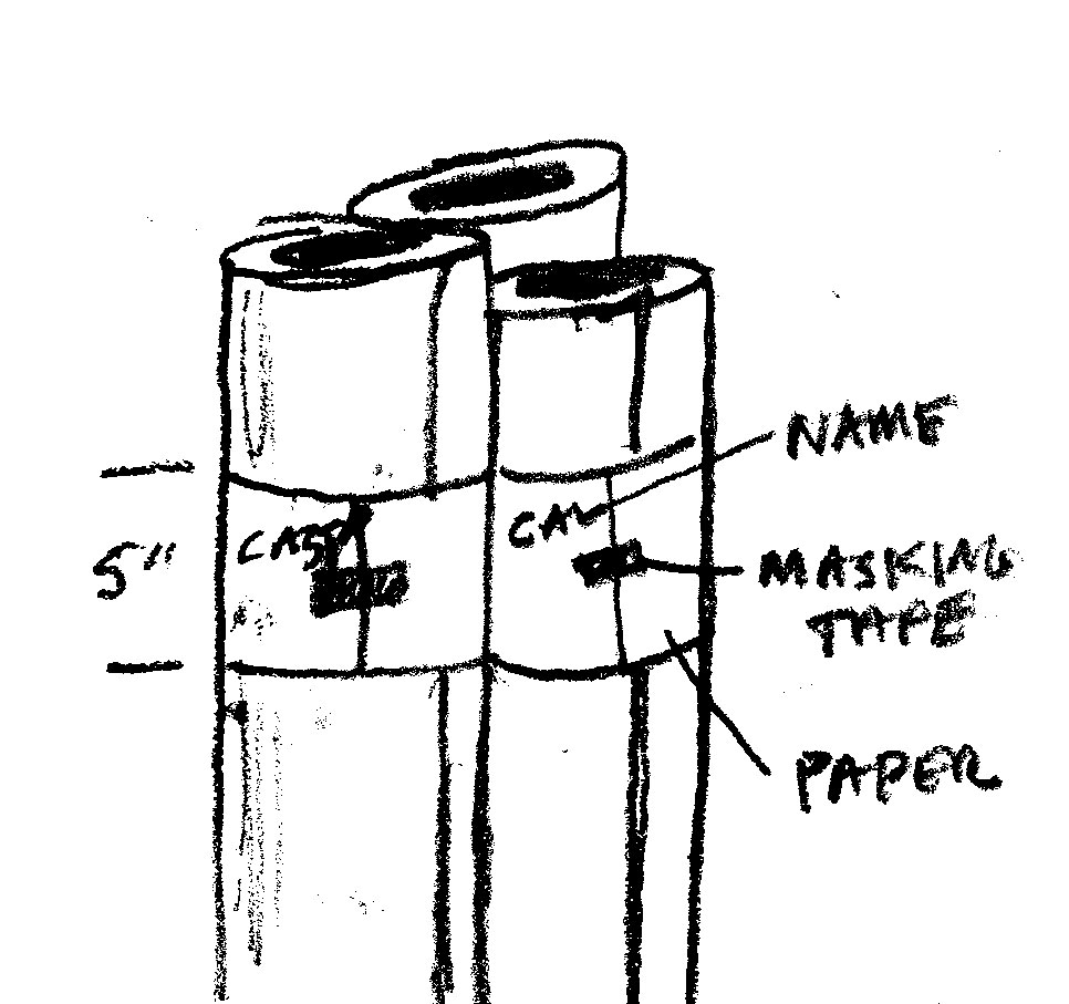

I do not get that involved with the labels, after I take it off the roll I put on top of printer.
Just take a 4"wide by 12" with a strip of masking tape and write what it is on paper. I keep the plastic sleeve that comes with the roll over it. So I just pull it out and read what it says. Sorry it is not something to get all involved with.
