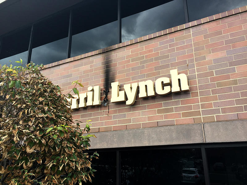

Not to be a :thread, but while all you electrical people are out there, what do you think happened here.
First of all, we did not build or instal this job. It's been up for almost 20 years. The other letters are not lighting up and they want me to replace it. I'm going over there later today or tomorrow morning, if it's not raining.
Maybe I'll start a new thread, so it'snot confusing. Sorry.
This is exactly why I started this thread! To prevent something like this happening! :Big Laugh

Used to see sign fires like that a lot 20-30 years ago when neon was the preferred method of lighting channel letters.
Probably arced out due to poor installation, failure to maintain proper distances from something it could arc to and failure to properly insulate.
That's the kind of stuff that caused the crackdown on electric sign installs, though flourescent and LEDs rarely have those types of issues.
