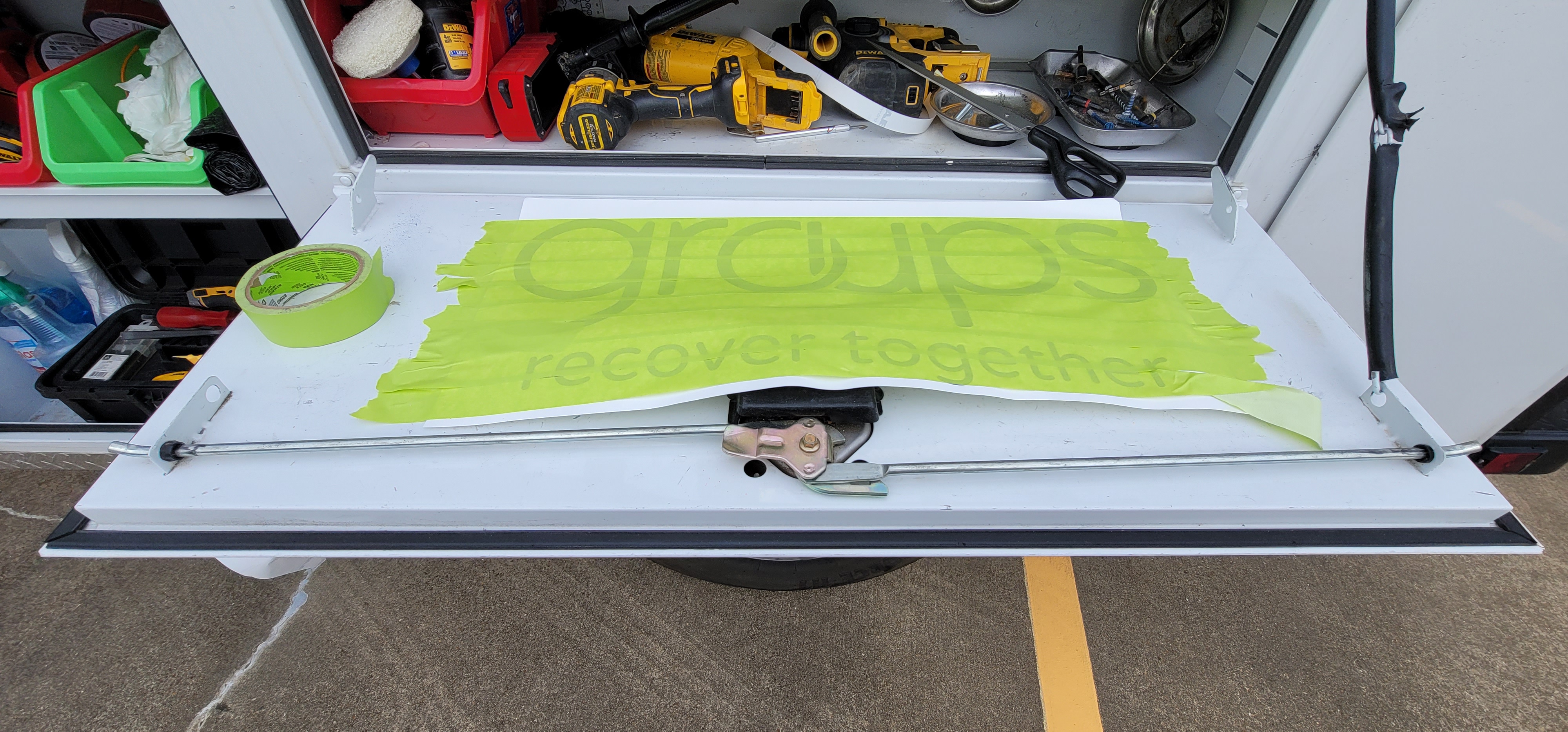

If you forget the premask
Texas_Signmaker
Very Active Signmaker
Just use up a $5 roll of masking tape! Beats driving back to the shop.
Johnny Best
As long as the green tape has less adhesive strength than the vinyl copy he should be OK. The tiny bubble lines from the tape may cause a problem on the application.

I just carry a 4-6" wide roll of mask in my tool box along with painters tape (used on mask to lineup on the window or whatever). I've used it twice in about a years time now but it takes up very little weight and I tuck a little swifter pad, to wipe dust and crap away, inside of the tube.
