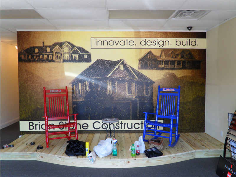

The 180Cv3 with the 8520 went on really smooth. Looks like wallpaper. Overall, I was really pleased with the way it turned out. Here's the finished product. Don't knock the chairs...they were not there when I installed it, neither was the deck.

I just treated it like any other wrap really. I found the center point in the wall and started with that panel. I hinged the vinyl, but really close to the top. About 12" or so.

Since you're in Georgia (and possibly so is this mural), you should have recommended that they replaced the big blue "Florida State" chair, with a children's-sized one to "make the mural "more visible".
sghobbies
If it were my call, there would be no chairs at all.....OR....make the deck look more rustic and use some "old" or rustic chairs.
MikePro
hah yeah, i'm just goofin' on a friday... i'm sure you guys have plenty of Florida St. fans in the area. SE wisco here is flooded with cubs/bears fans, so its always fun to poke fun of em'... especially since Badgers/Packers/Brewers are DOMINATING right now!
sghobbies
I'm not really sure what his motives were for building the deck. Unless he just wanted to show that product. This is his showroom for his residential side of his construction business. I still think it would look better without it.
