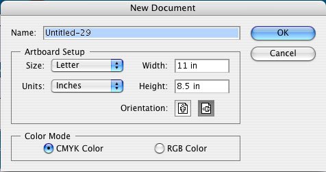

Does it now show up in the initial new dialog box? I think after you do it once it remembers for the next time.

Yes, it opens in CYMK mode every time with .eps or .ai files. For some reason the image in the initial window can't be seen so I select all, copy, close that window, open a new window (which I set to open as RGB) then paste the object.
