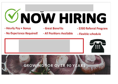

I received a file from a customer and I had to re-create it, as it was grainy already and I had to blow it up. There was one small picture file in it and when blown up, that looked fine, but all the copy had to be redone. Fine. Re-did all the type and set all the black copy to BLACK only. No CYM stuff..... just black. I needed to put a clipping mask on it to make sure everything was kosher. When I send it to print, it turned it into 6 color black. I went back and checked to make sure I had made it all black and I sent the file again. Again it printed all 6 colors to give me black. I have a reason for not wanting to use all the colors at this moment, so does adding a clipping mask change that value/color makeup ??
Underneath the grey boxes is more black copy.

I imagine it's changing in the RIP, cause when I open it again in illy, it still shows all black. When it prints, it's coming out in all the colors. However, I don't see much magenta showing up, but that might be going down last.and I just can't see it.

The parts I re-did were CMYK..... and my scale shows 100% black and nothing else. The RIP is Wasatch.
Don't get me wrong, it ends up being black in the final print, but I did not want to use the other colors for a reason, but they still were used. I was trying to eliminate all colors when black was used.​
