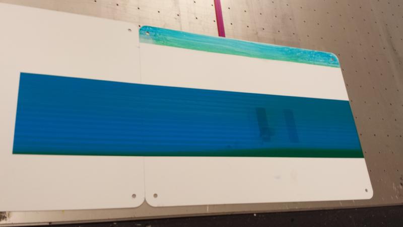

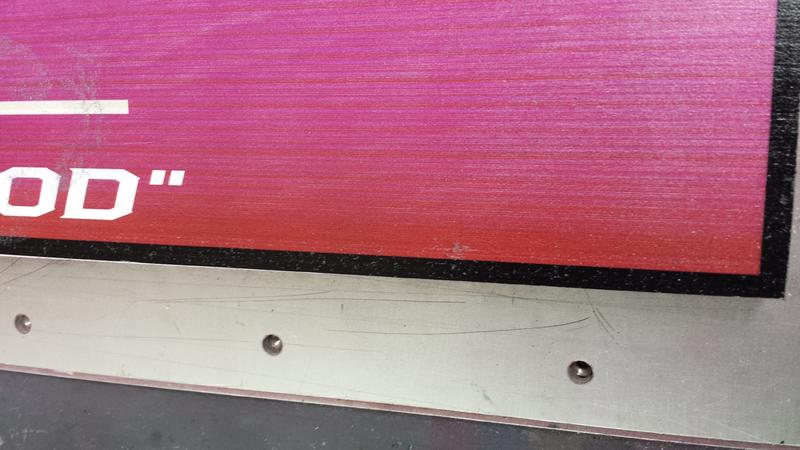

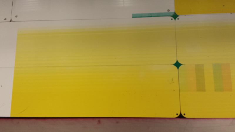

I am having an ink drop out issue. I had a tech come to work on August 6th and since he has left we have slowly seen an issue with yellow ink dropping out. I use to be able to do a head clean or pump motor draw and get it to print ok but by the time it would et to the end of the table the yellow color would drop out almost entirely.
Well here it is two months later and the problem has gotten so bad yellow drops out in about two inches from the start of the print. I have a different tech here just to work on this issue and we thought the yellow head was bad. So we have replaced the head, damper, pump, electric head cable, rubber cap and about everything else associated to the head. Once the ink drops out I do an immediate test print the all the nozzles are almost perfect.
I have attached a couple prints to give you an idea of the issue. Would love some help. Could this be electrical?

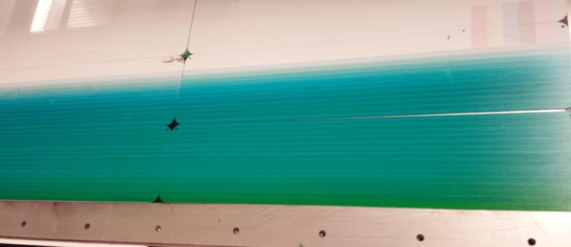

ok we have swapped the cyan and the yellow ink lines and dampers and tried to print them both together and sure enough the color changed to teal ( not as blue as before, it was dropping out slower) suggesting this might be a yellow ink issue?? Would love your thoughts? What would you do next. Here is a picture after swapping yellow and cyan lines and damper. Also after running yellow through the original cyan head, we did our test draw and now the yellow in the test draw is showing quite a few missing nozzles going through the original cyan head. Sorry if this is confusing. I am confused myself.
The bright blue image is when the lines were hooked up correctly and the teal image was after we swapped the yellow line and damper to the cyan head and the cyan line and damper to the yellow head.
