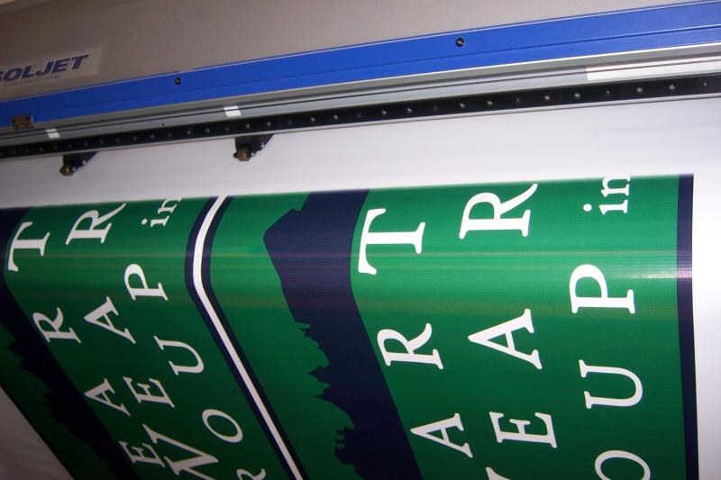

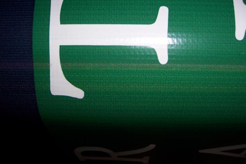

Thanks in advance for any help. Here is my problem.
After getting between 2' to 6' in on any print or material the printer seems to partially drop out certain colors causing a light
banded area ranging from 1/4" to 1-1/2" wide. It's sporadic when it does this and it always seems to go right back to proper
printing density again. The capping station is fine, pump is fine, dampers as fine, cartridges full, no air in the lines. I am not
a service tech, but no idiot with these either, I am baffled.
Printer is a Roland SC500 running Wincom eco-sol inks. I had the same problem with Rolands eco-sol max. It's not the inks.
It's not a software issue either as it doesn't matter where I output from, Flexi-pro 8.6 sp1, corel x3, Roland colorchoice, it still happens. It also doesn't matter what resolution I output at either.
I will attach a few pix for review.
Thanks for any answers & ideas,
Greg Savage

David S
If there isn't any air in the lines then I would check the seal from the damper to the manifold on the Printhead. It could be a cracked manifold if it is always the same color. If it is all different colors then ????
woolly
do you allow the printer to pull the roll or do you unroll some slack every now and again while printing.
that type of print problem can be caused by static as you unroll some slack. then it returns to normal printing again until you roll a bit more out.
