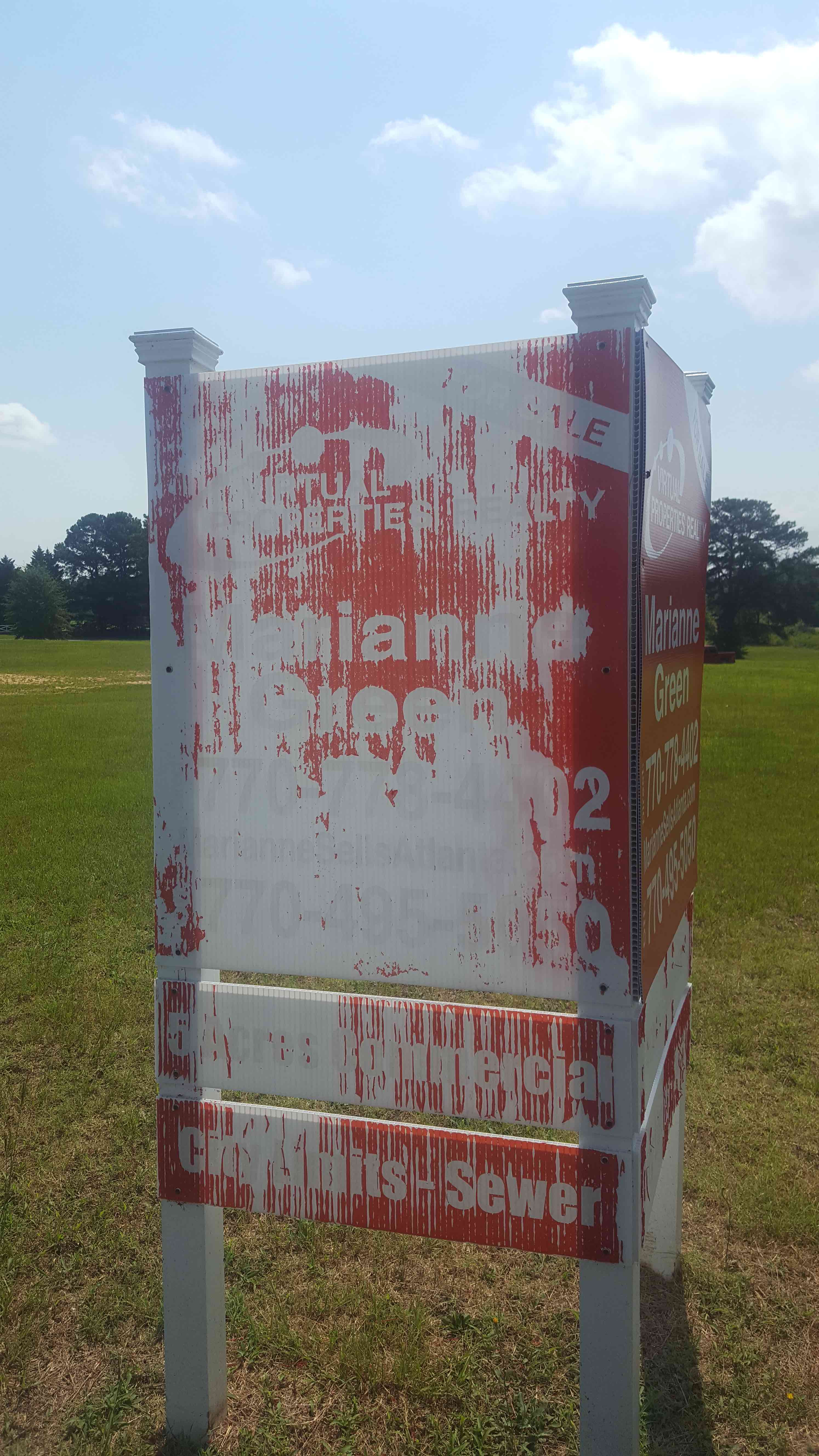

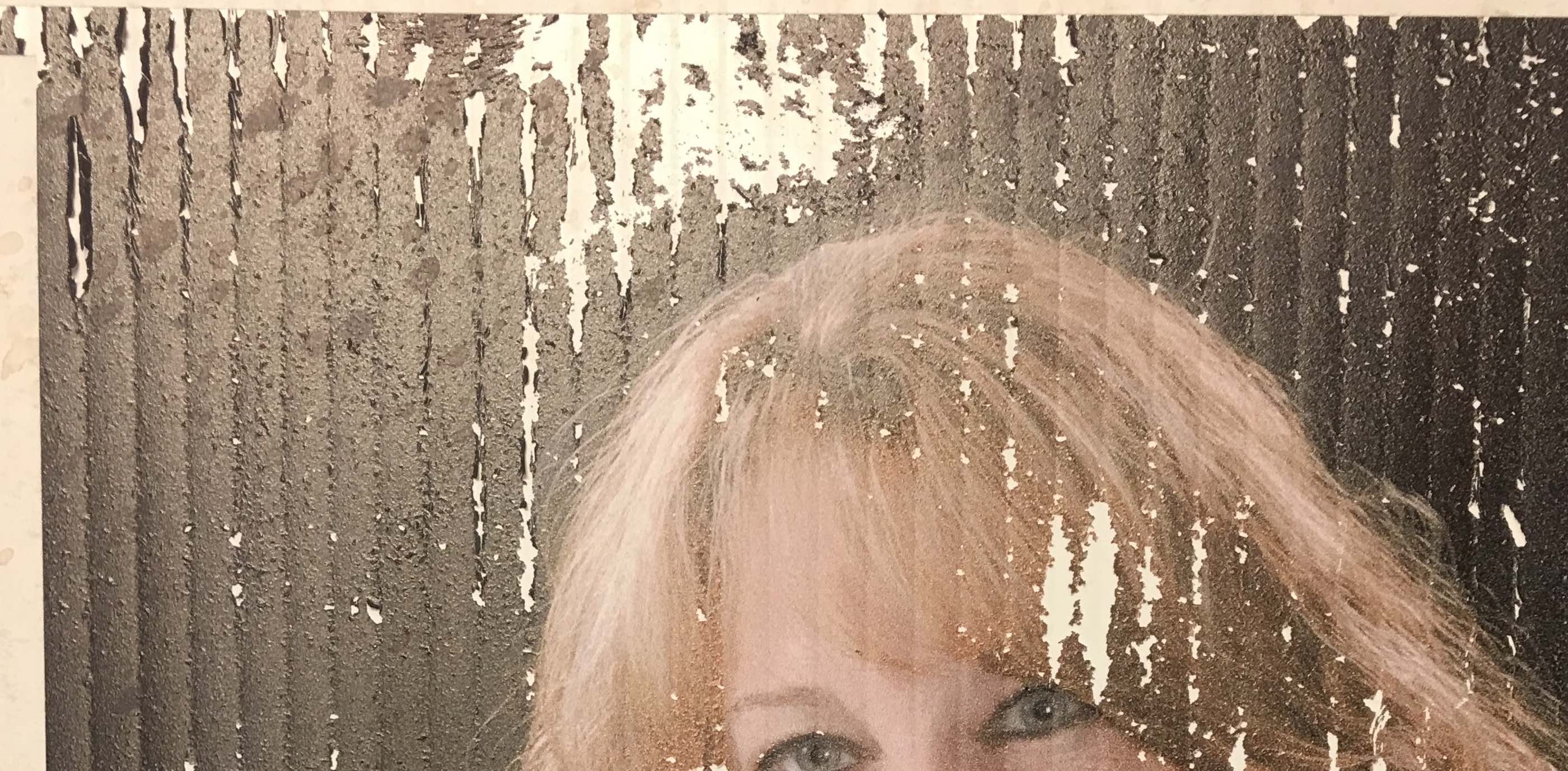

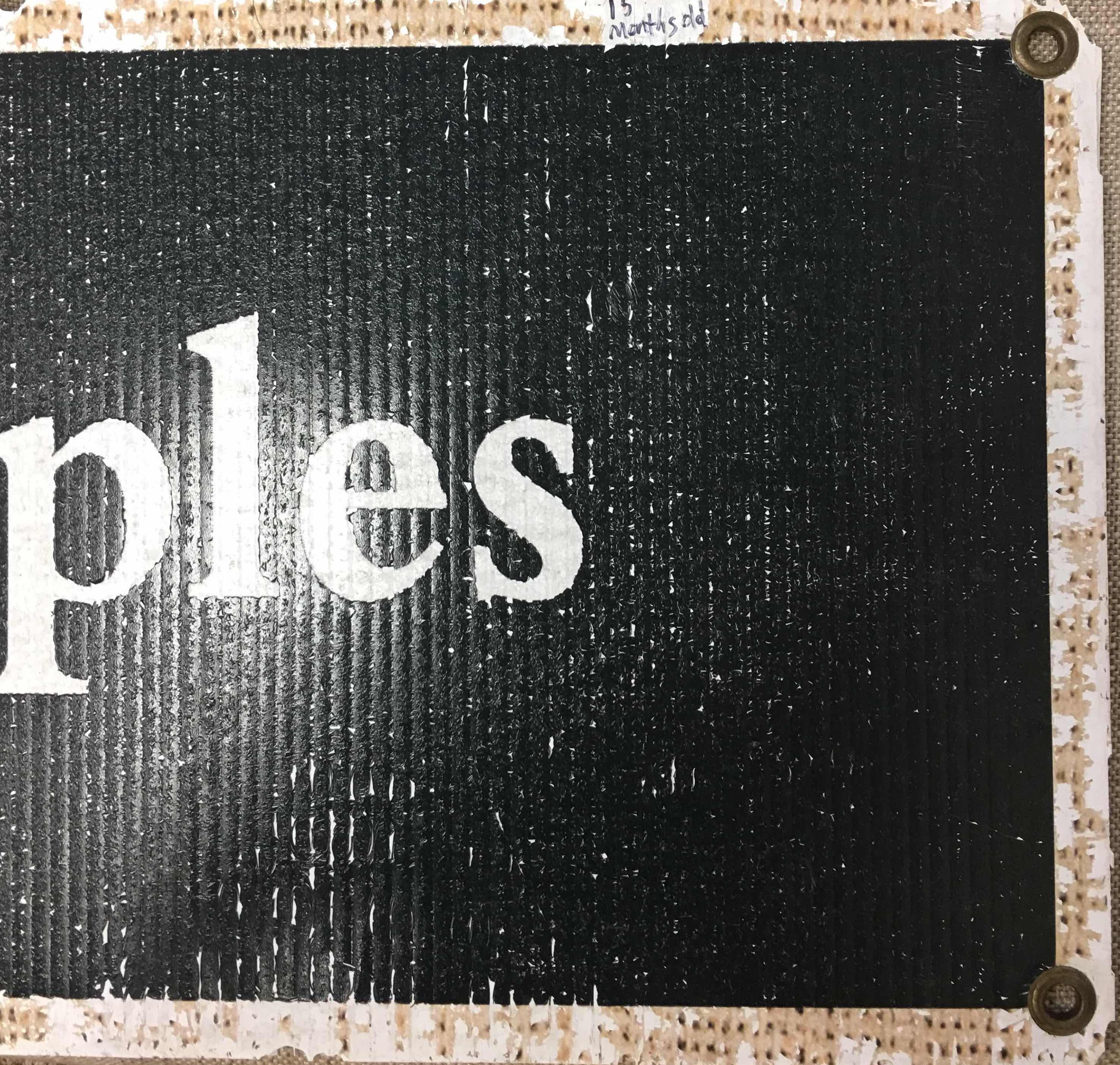

Hello,
We are experiencing [HASHTAG]#inkflaking[/HASHTAG] problems on our corrugated plastic prints. We print direct to surface on opaque corrugated plastic, intepro and coroplast brand, although I believe they are one in the same now. We use either a Mimaki JFX-500 or JFX-200 and we also have a megacoat XL UV liquid laminator which we use right after printing the signs. We have also experienced this problem with signs that have not been UV coated with the liquid laminator from several years back. The sign is so indestructable right after this process that it is unbelievable that it could flake off the way that it is. We also print direct to .040" aluminum and .080" digitially receptive styrene and have not had any complaints about them. 6 months seems to be about the amount of time it takes to see the problem developing. Testing is very difficult because the signs leave our shop looking and performing great. I'm attaching just a few of the photos of the problem that we have encountered.
Mainly looking for answers but anyone who is experiencing this problem I would love some feedback.

We are using OEM LUS-150 inks on both machines. We have contacted Mimaki and they know of no problems. This has been happening for about 5 years, I suspect a lot without us knowing as it takes a customer complaint to notice and I suspect a lot of customers just go elsewhere and say nothing. We have used coroplast brand and intepro brand plus a few other types here and there( I know this is not helpful). Our signs don't just leave the shop looking amazing, you can't even scratch the ink off with a blade. The UV coating is rock hard after short term testing in our outdoors around the shop, we have found that it holds up outstandingly. Something changes about 6 months down the road. I suspect Expansion and contraction but this would mean that all corrugated should be having this problem and I can't find any other shops that have such a large problem as ours and we all buy from the same places.
On the real estate sign, why is the side we can hardly see looking fairly decent vs. the side you're showing us, isn't ?? That doesn't sound like an ink or substrate problem, but perhaps a prepping problem.Sometimes, when buying stock, the corona on them goes away, from what I understand in as little as 2 or 3 weeks, so if you have old Cor-X setting around, there might not be any left on it. Also, we were told years ago to use 91% isopropyl to wipe it down and keep rubbing til it's dry. Do not let it air dry, as that does more harm than good.
Luke Sellers
The reason the real estate one looks good on one side is because about 3 months ago that side was the only one that was flaking. SO we printed a panel and put it on top of the old one. Now we are dealing with all the rest of the signs at that site.
We use 91% iso alcohol to wipe down ALL signs no matter the material, and we wipe until evaporated. Again, adhesion issues at the outset is not our problem but good observations.
As a side note. We order corrugated by the pallet load and it does not sit around. We go through a pallet in 3 weeks.
