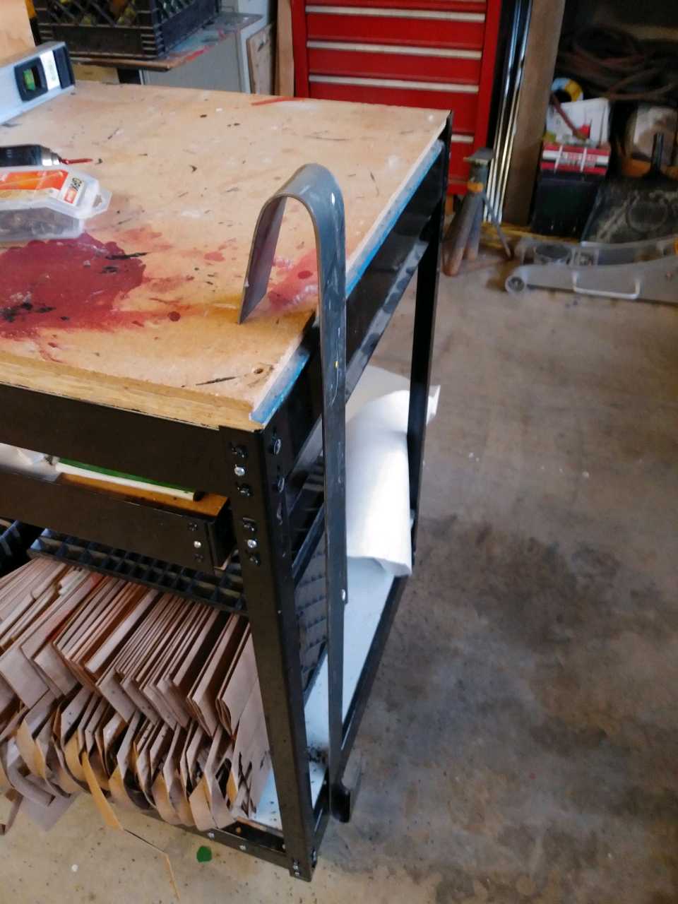

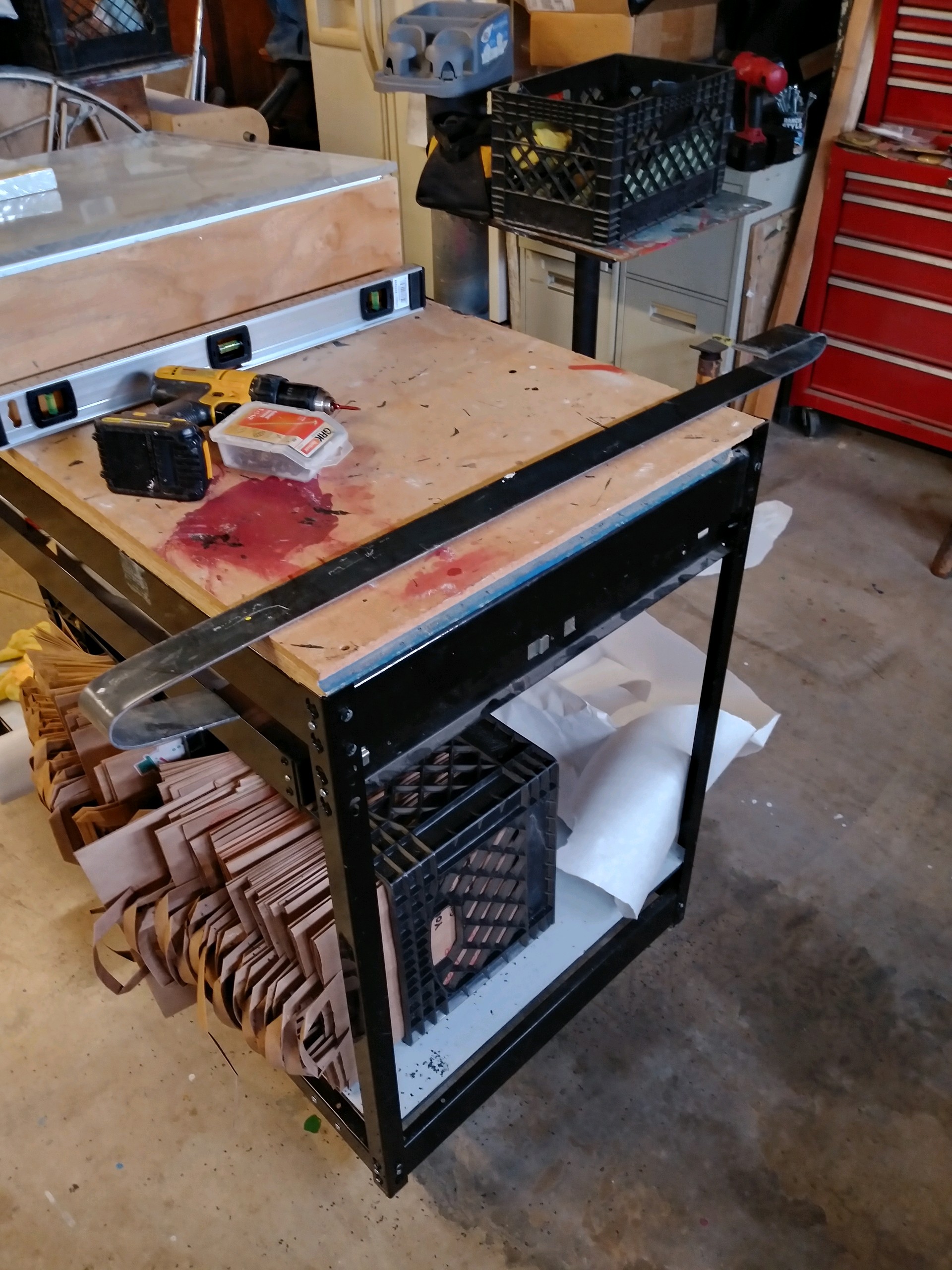

What ever you do you need two "z"s made of 1/8x2 steel strap x 4' long. one end hooks over the guard rail and drapes below giving you a hanger to hold the sign from the lift. Mine go with me anywhere I use a lift. A bungee or a hand keeps the blank in place when in the air.
can you post a pic?
Jer Barlow
Kinda stupid simple. Great when the wind blows.
