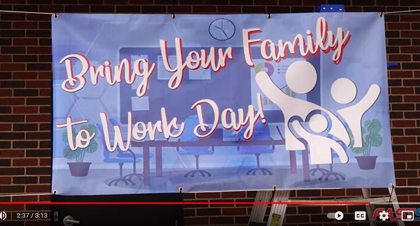

Good ideas, but way too much work for a temporary banner. The customer had a budget limit and I hit it, and that's that. During the install all I could think about was this video.
