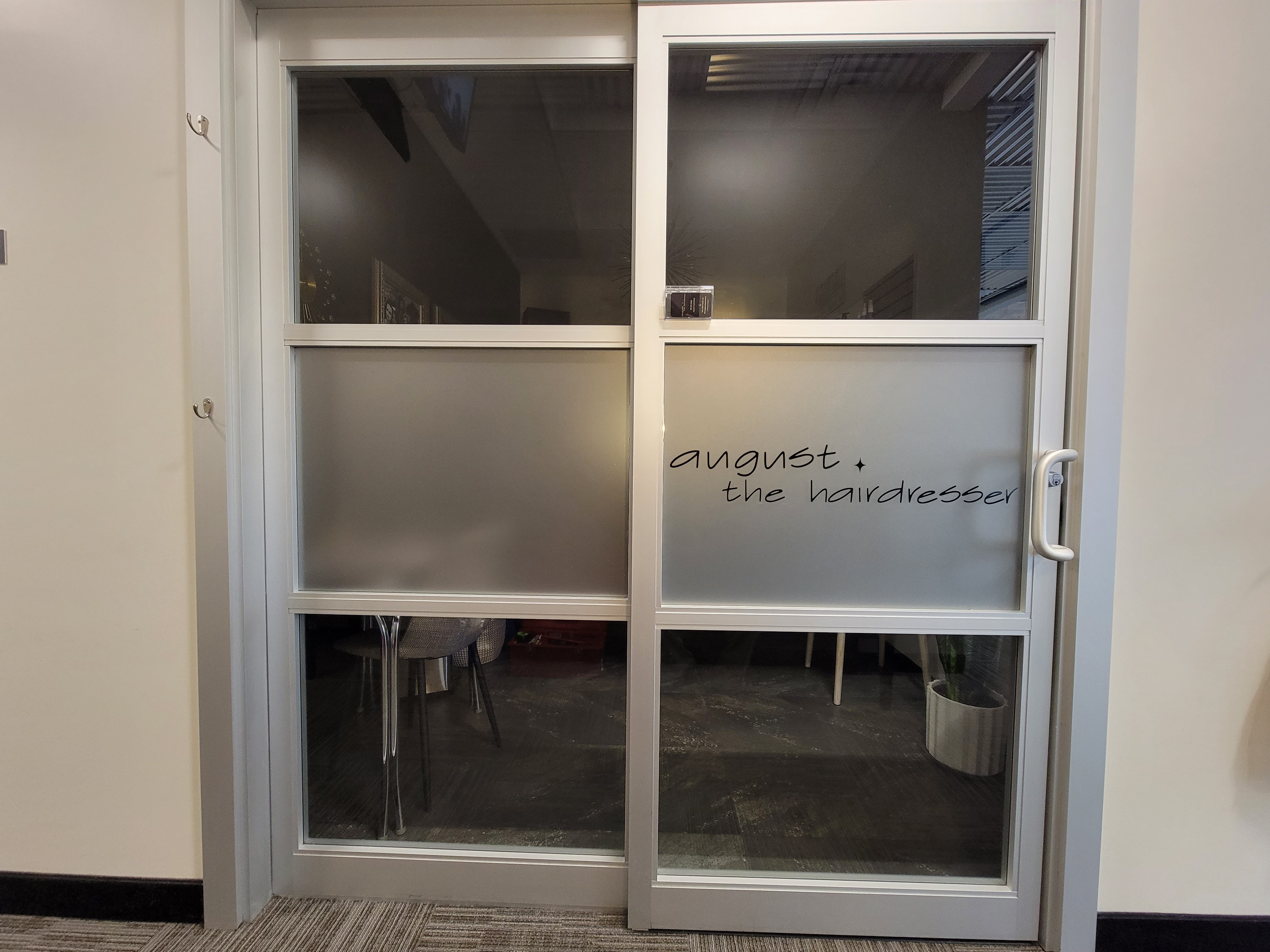

Then it would sounds like outside of operating hours are the only way to operate this job if that even would save it. It is a tight corridor setup (probably 4ft wide) that runs in a rectangle "ring" on the inside and outside of this ring. One one is in their own room with 3 window panes on the wall and 3 matching panes on a sliding door.
I mean honestly this almost sounds like an attempt at ironic humor. "I installed vinyl graphics at an operating hair salon and there's a hair under the vinyl." I feel for the OP, it seems like a nearly impossible task accomplish.
I don't suppose it would be possible to install in smaller pieces so it would be easier to keep it hair free?
They are wanting a frosted window pane so not sure that works. Photo attached.

Wait a minute....... you're putting this on, on the outside of the door ?? How can you claim they are contaminating it ?? I thought that was a reverse application from the inside.
DeadDoc
It's essential a barn style building. I am not claiming anyone is doing it but there are lots of salons inside this building with doors open and everyone has to walk by me.
