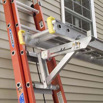

When I built my house I used them 24' up in the air, I have ladder jacks that hook onto extension ladders.
Like Mosh, when I do paining or remodeling I use ladder Jacks on two extension ladders and the Werner work plank between them as in photo, the ladder Jacks can be installed either on the inside (towards the house), or the outside depending how high you want the work platform.
I have set it up pretty high, 20' or so, very scary as there with no HAND RAILS and TOE KICKS, which are required by OSHA a that height.
Mosh
I usually put them towards the house, I have a walk-out basement so one side on my house is pretty tall in the gable end.
