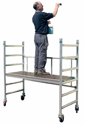

We use what's called a "baker". Kind of a mobile scaffolding unit that painters use. Ours has about a 30"x96" plank.
Closest picture i could find on google is this. Not exactly what we have but close.

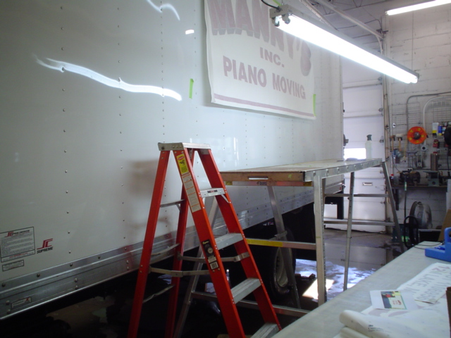

This is what we use- 2 tripod adjustable stands with a walkway on top- this one I built (17 years ago) from an alum extension ladder taken apart and welded together with plywood deck- it is 10' long we have a commercial 14' one as well. The tripods I think were called Mustang. Gene

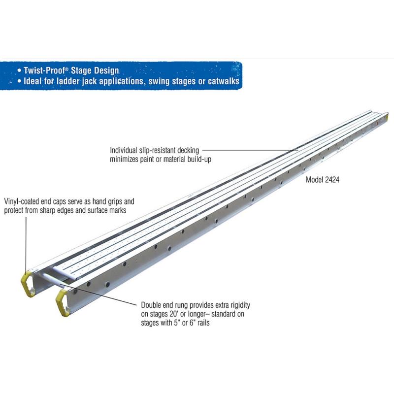

I have the Werner 8'-13' expandable work platform and have used it for over 10 years, it works great for ONE person, I have on occasions had a helper on it, but it is very dangerous because it is seamed in the center, that is where it will give and break, why risk an accident.
It's rated at 250lbs and works great fro me alone, I use it all the time, however for larger jobs that require 2-3 people, I use the Werner 20' work platform which is rated for 500lb, it's one piece and very strong, I have had three people on it and NO flex at all, worth the money.
http://www.lowes.com/pd_65500-50116-2520_0__?productId=3370432
Remember this, you can pay the $500-$1,000 now for a safe work platform, or you can pay that or more for an ER visit, not to mention the loss time when your arm in a sling!

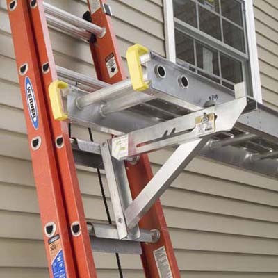

When I built my house I used them 24' up in the air, I have ladder jacks that hook onto extension ladders.
